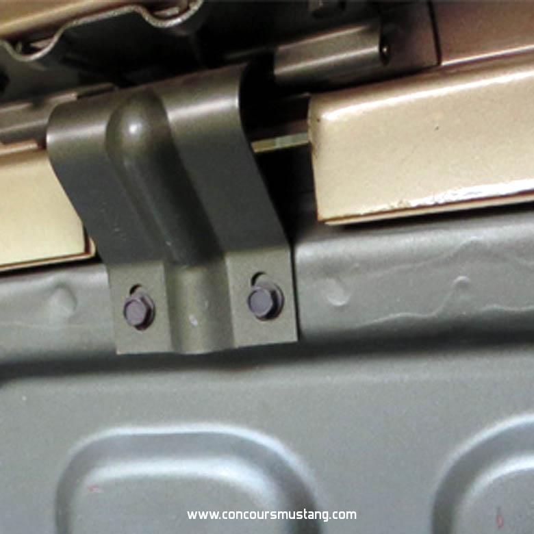

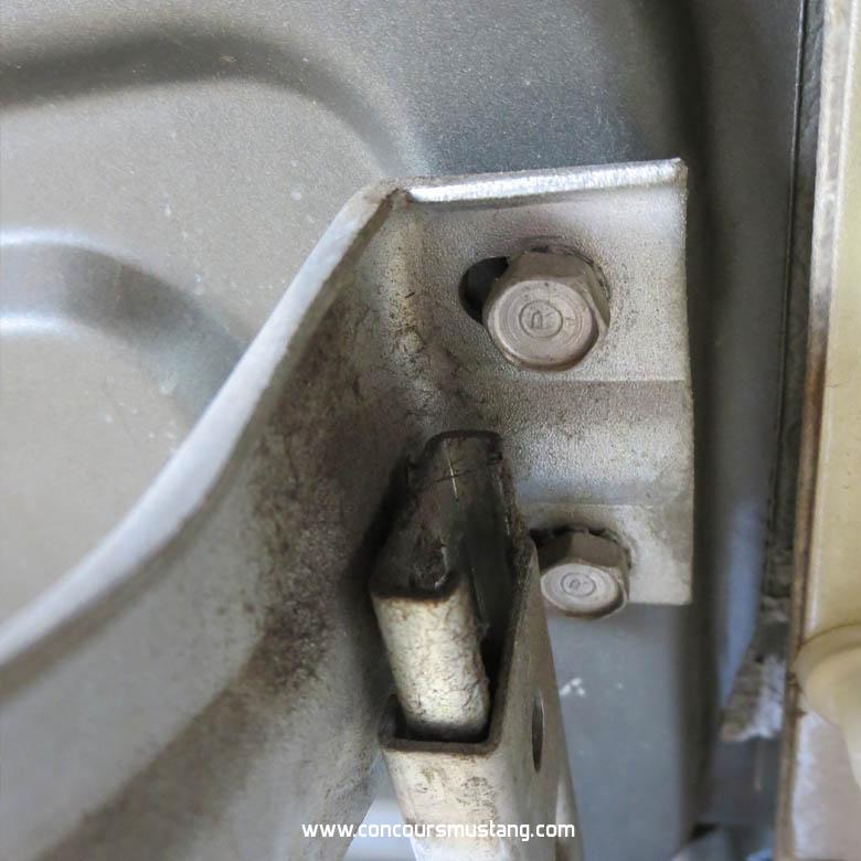

Was wondering what color the backside (trunk facing) of my trapdoor would have originally been for my Oct 64 San Jose fastback.  Interior is white / black, code D6.  Front side of trapdoor was white, but backside was covered with carpet.  Unfortunately the body shop media blasted the trapdoor before I could look.
The first two pictures are my car.  It looks like the hinges were originally white, and then may have had their lower halves painted black, I assume during an amateur resto.  From the hinges, could I assume it was white originally?

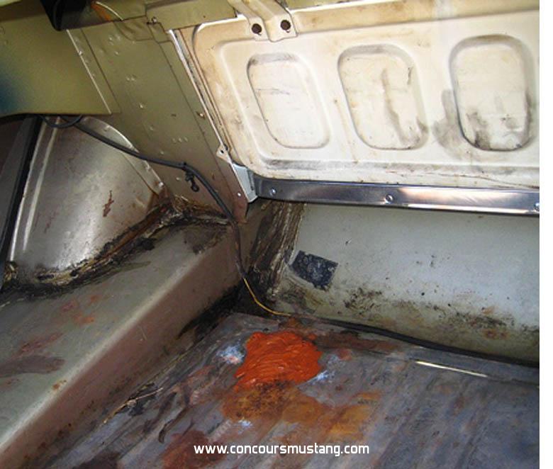

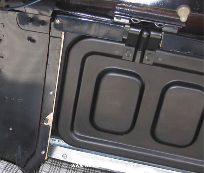

The last two pics are from Jeff of a black trapdoor and from ChrisV of what looks like an ivy green from his car.  (Hope it was ok to repost).  Also note that it appears the hinges were ivy green as well in the last pic, matching the trapdoor color.
Finally, what would the paint finish be?  Looks like a satin or dulled like other interior pieces.

Close up of the hinge.  Looks like original white with black paint or black adhesive slopped on the bottom.  I maybe can make out white behind the hinge too.

If the fiber glass panels in the back are white so is the trap door on both sides...Mine is pretty flat not gloss really (color code 28).  OK to re-post my pics ;)

Back side of the trap door is the same as the interior. The "fiberglass" side panels have nothing to do with it - originally they would be unpainted on the back side - sort of a light tan finish that matched the base color of the material used to make them. Ford/the supplier didn't paint he back sides so they often contrast and are something just about every judge checks as they are often painted :(
Example - Interior is black
Finish would be exactly (same paint and painter) as the interior. Closer to satin (very slight shine in the right light and angle) often referred to as egg shell in today's terms
On this year hinges were painted the same color/finish but before they were attached to the trap door or car
65 San Jose white interior example

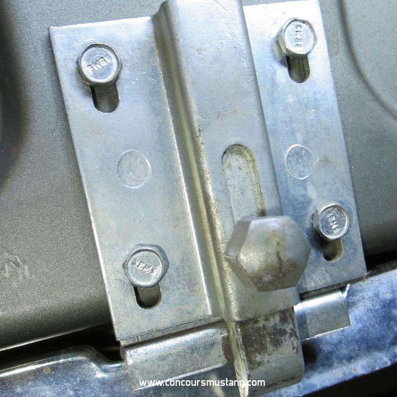

Another one,  is the finish on those hinge screws P &  O?  They look dark.
They were a dark flat finish from just a look (not testing ;) I believe P & O would reproduce the look well

Jeff - yes, restored car using AMK hardware kit.  I don't know where Max got the idea these were red.  The assembly manual shows S2 (P&O) finish on these.
The red looks cool though doesn't it?  :D
Would guess that he's just selling one hardware set for two or more purposes. Looks like they are the same size as the ones used to hold the 69-70 rear seat (sportroof) latches to the body and those were dyed red as a safety measure

At some point the hardware and hinge for the trap door was changed,
smaller screw from my Oct 64 Dearborn build.
So yours is the upper set of screws?
The first one I posted was from late (24th - projected) Oct 64 San Jose for comparison.
Guess we need to look at earlier fastbacks to find the trend - Believe  that the smaller was the earlier.
« Last Edit: September 20, 2015, 02:53:39 PM by J_Speegle »
Jeff, yes, my Oct 64 Dearborn had the smaller/darker screws pictured next to the red hinge.
The larger screw and hinge came with a trap door I picked up in a parts lot so can't verify its origin.
The slotted holes in the black hinge for the screws is larger than the slots in the red hinge .
