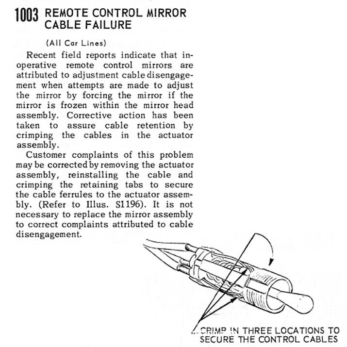

Was just scanning some TSB's for other threads and since this was in the same group as my focus thought I would post it here. Seems that Ford was having issues with the remote mirrors and addressing customer's complaints. Here was the Fords instructions to the service managers in March of 1967
