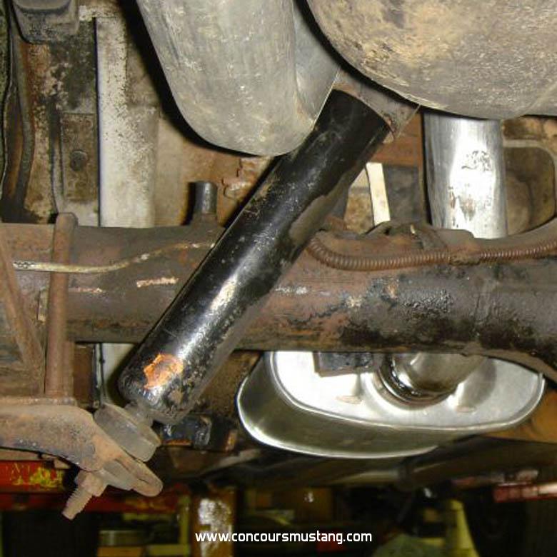

The build sheet for my car under SHOCKS, line E, calls out ORANGE.  Does that indicate KONI's or something else ?   Metuchen, Sept. 19,1968 and Mach 1.  Thanks, Brian

The shocks were black with a spot of orange paint I think.
I think he orange spot was what the production line knew what shocks to use.

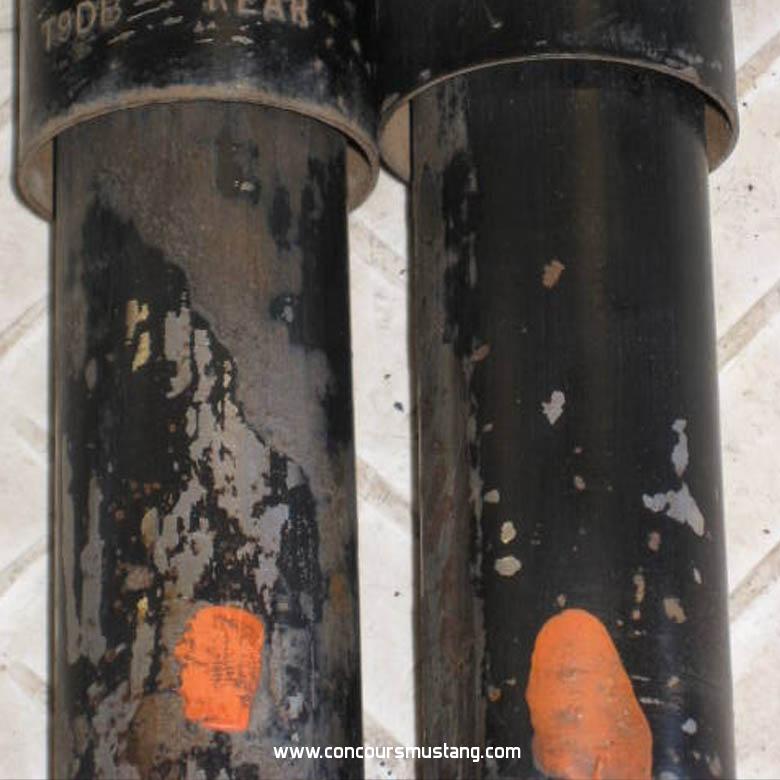

The buildsheet was the guide fro workers on the line to build the car. The items listed on the buildsheet were coded by letters, numbers, part numbers (shortened) and colors so that the worker could pick out the correct part for the particular car to speed up production. The codes, letters and numbers were labled on the bins for quick identification of those parts while the color coding made those parts (sometimes in racks or other holders) made that quicker
The Orange was just a simple somewhat small paint daub applied to the bottom end of the shock for that application. The rest of the shock would have been semi-gloss black as mentioned in many other threads here on the site
Guess your front shock on the buildsheet might be marked with white

Rear shock marking of orange would be correct/normal for a 1969  4 speed 428CJ equipped car.

No white would be front shocks. Rear for automatic marking was violet. For full year from what I can tell this moment but it would really help if I knew when your car was built ;)
