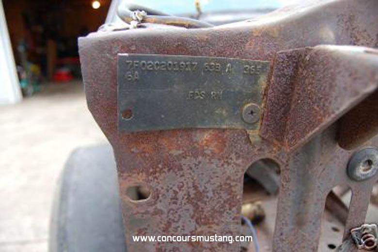

My 67 fastback was Dearborn built on 4/21/67. Where would the Buck tag be located? Marti report just has a - mark on the report where it says Buck tag. I ordered a new one from him & want to put it in the right spot.

This should help - Passenger side, front face of the radiator support

The screw shown in the picture is used elsewhere - depending on year. The first place that comes to mind is retaining the roof weather strip channel to the upper edge of the door and window opening

What would be the correct screw for the OP, My car was built the same week and same plant and seems to have the same incorrect screw.

In addition to the location Jeff mentioned, I find those also on 67 upper console mounting brackets, 67-68 fastback rear interior panel brackets, 67 dash pad where attached to the windshield structure, and a few other places.  I've got a bunch of spares, PM me if you need one.  I'm sure others here have them and would do the same.  Phillips head, disproportionately large, sheet metal screw.  I would have to look again to see if it is self tapping.

Sorry I wasn't clear the screw in the OP's pic IS the right screw ?

I'm not seeing a pic on the OP.  Jeff's reply shows the screw, and would say that is the style I see as well.  Same screw I've seen on Metuchen buck tags, but of course they are not mounted in the same location.

Have seen other style screws used - on other plants and years

Thanks, My mistake Jeff's pic- uses same screw and same location for the buck on my 67 Dearborn car.

For others viewing the picture I posted notice the horizontal line in the metal plate.
You'll find a discussion of some of the plants "recycling" the door and warranty tag blanks as buck tags in at least one other thread on the site.

Funny how what caught my eye that it was a warranty plate was the perfect rivet hole on the left side of the tag. I completely missed the horizontal line.  :o
