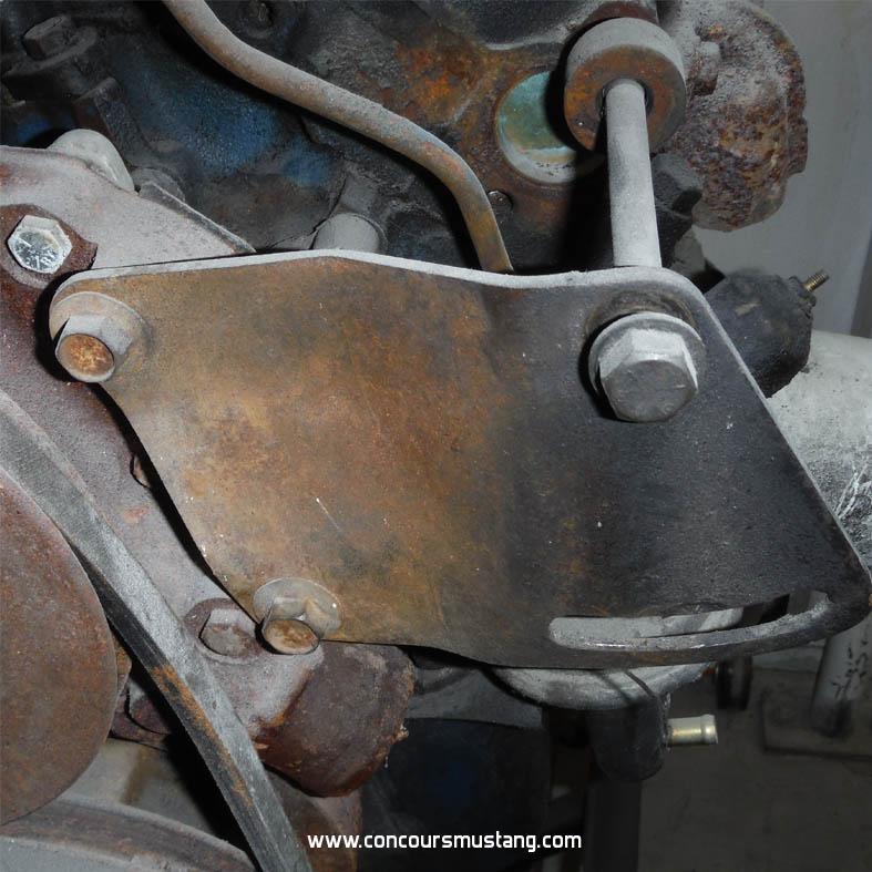

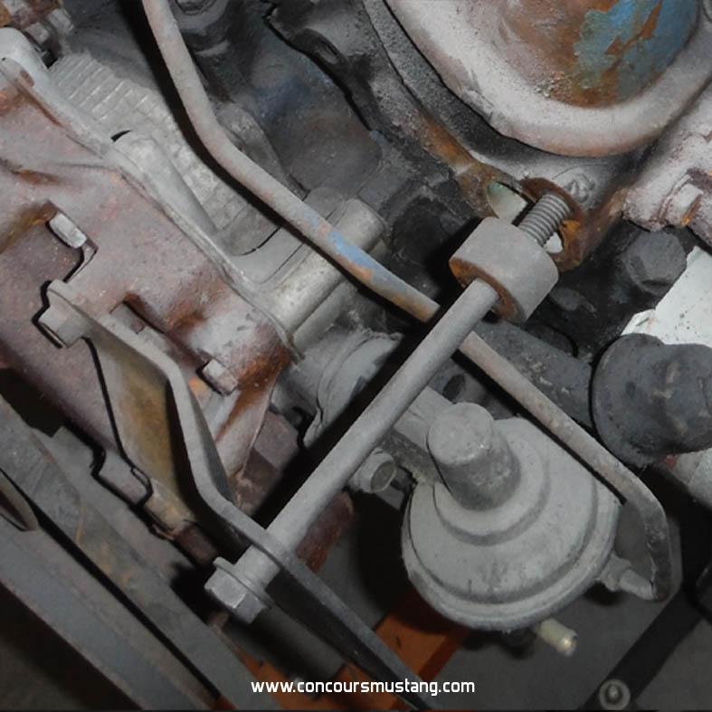

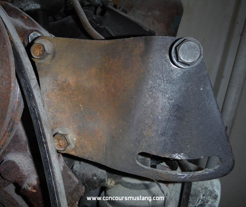

Did you look at the pictures of the unrestored 1970 unrestored car in an older thread. It's a F code, PS non AC example with some pictures of the PS pump area of the engine compartment,
It's a start but we can post more if needed.
Search feature is your friend. Try 1970 unrestored F code
Should provide some idea of mounting hardware, brackets and finishes

Totally amazed,,,, I found it like you said and its answered every question I had on the power sterring and then some I did not know I had..., even down to the colour of the power steering pump, but mines black this ones teal blue.
that's a complete freak, I have the same window wiper connection to fit and fix and the rubbers near them... that exact photo, I wondered where they went...
But the alternator mount is not as I imagined.. not even in the same bolt hole in the head....
. I have the spacer but not that extra little thing behind the spacer on the head, part is the dipstick holding bracket but there is something else..?  hmm that one im not sure on but that's enough for now..
that's just gold...

and my other question is the pictures you directed me to..    totally spot on, the alternator bracket on the head, then a spacer..what is that bracket..thats what im missing
I have the bolt the spacer but no extra bit on the head there between spacer on bolt and the head...
really appreciated...
and mine was gong to the outermost bolt hole..clearly wrong, not the inner head hole closer to inlet manifold as the picture shows..
makes me question my current alternator bracket too because it appears to line up with the outer bolt hole...? im still lost there..ill have another look at mine and stage it up and see where the bracket sits and where the nend bolt pivot hole seems to line up with. might have wrong bracket...
but your picture looks exactly like what I should have

Re: 1970 coupe 302 2v power steering brackets
« Reply #4 on: January 17, 2016, 05:54:06 AM »
re the power steering pump, I cant find any identifying code to determine if its the teal blue or the black provider of pumps,
the post says on FAQ ( this site rocks b the way )  ......so where is that tag?
Originally (a metal label or tag) on the back side of the pump and was held on to the shaft (where the pressure hose attaches in the center) by a large thin nut

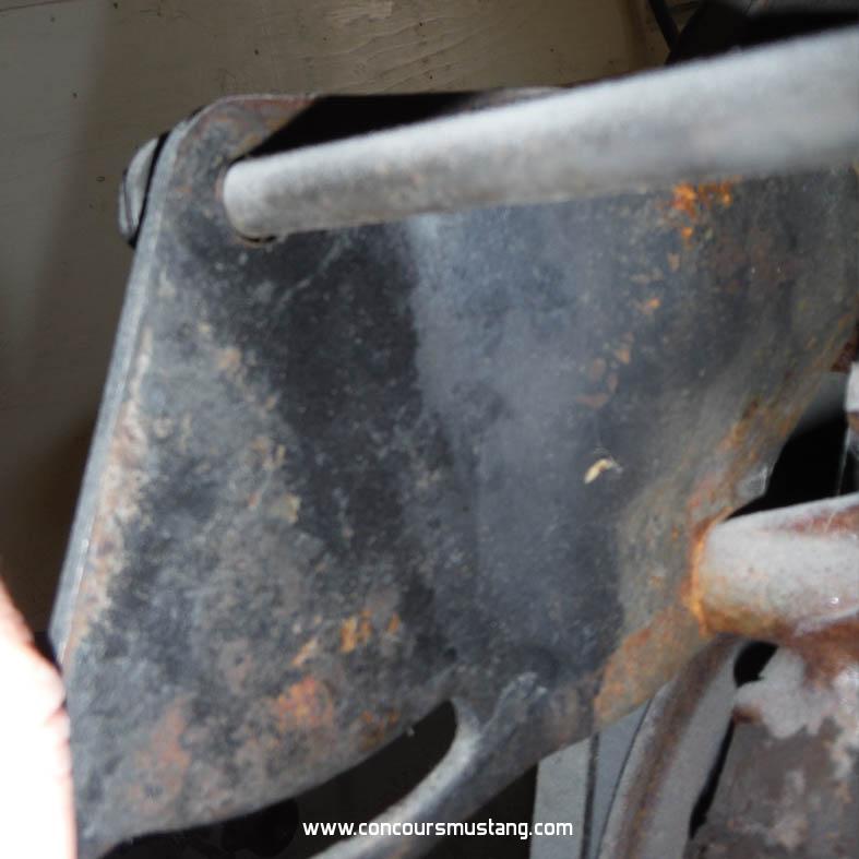

None of my pictures show the engineering numbers (too much stuff in the way)
Only thing I can think of is I know where two F code 70 convertibles are being redone. So there has to be two of those sitting on a shelf when I stop by next time.  Only way at this point to make sure what they used originally

Thought you were looking for a bracket for an F code not a 351? That would be a -E (part number) not that -A listed in the link you included in your last post and the 75 version of the MPC shown above.
Think you'll find that the brackets were originally semi-gloss black or P & O
Did get an opportunity to take a little drive and get pictures of a fairly original (can see a couple of things that have been replaced) 70 F code PS engine
Looks like the challenge is that this correct/original bracket was not stamped or marked on the surface like other versions from what I could see. Last visit they had one more 70 F code but apparently that one got picked up. Interesting that the shape differs from the first one shown in response #9. Guess if the holes and ends are all in the right spots the difference in shape may indicate a different supplier for the later service replacements that your picture appears to be
