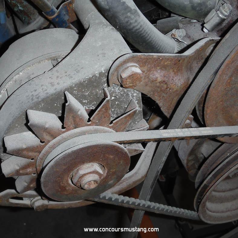

from the photos here on site there is an unrestored 302 2v alternator side photo of a bracket of some kind mounted to the head that then takes the alternator pivot bolt and spacer...
I need to know what that looks like exactly and what the alternator bracket that goes with that as a set looks like.
ill attach that picture to lead in with, then the photos of what I have at the moment and maybe we can work out what's missing.

The May 75 MPC shows:
D2OZ-10156-B front bracket
D0OZ-10A336-A rear bracket
D1AZ-8A652-A spacer
The spacer photos are from an auction. The seller listed the overall length as 4-7/8. This may have been a cut-to-fit application, but that MPC does not specifically state that or provide a measurement.
The front bracket photo is from West Coast Classic Cougar. They have it listed for all 1970-73 302/351/Boss 302. They list original P/N D0OE-10156-A.
"Eyeballing" it from your photos, it looks like your spacer might work if you get the correct brackets.
