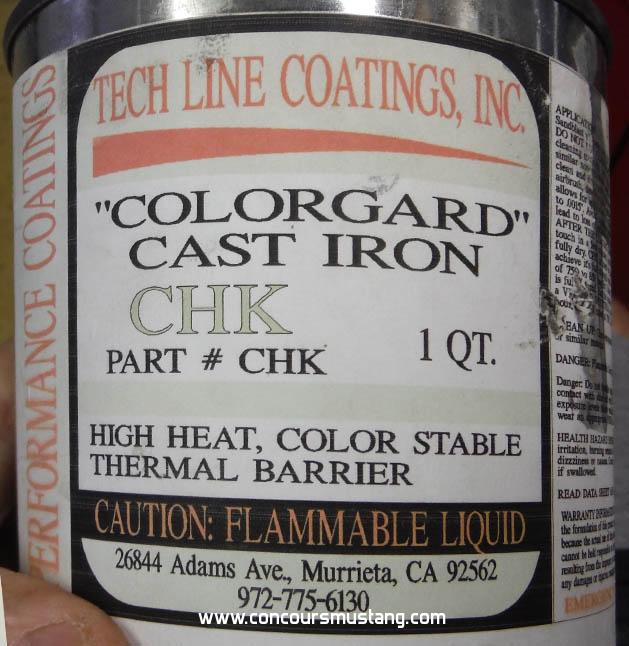

« Reply #7 on: January 23, 2016, 12:46:55 PM »
Thanks Jeff......what ceramic product do you use?
Will dig the can out and post the info.  Had to by a quart and have done maybe 4-5 cars so far with it. Plenty left in the can

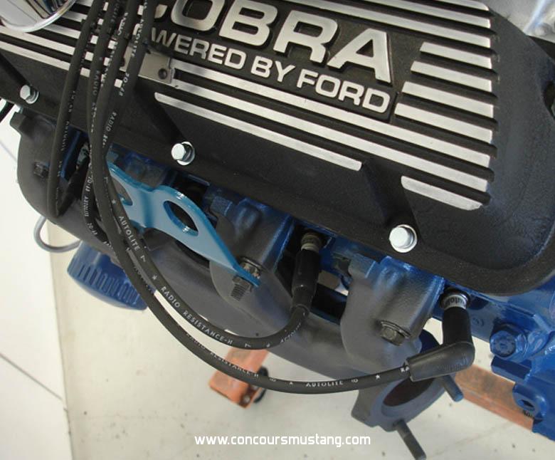

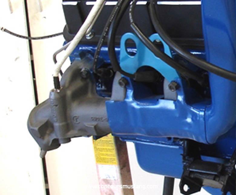

« Reply #10 on: January 24, 2016, 07:31:08 AM »
Here`s the cast iron Jet-Hott coatinq on mine.  I paid $375 to qet it done and they had 6000 miles on them in the third pic.
Not show-correct but the best option on an enqine that qets started up.

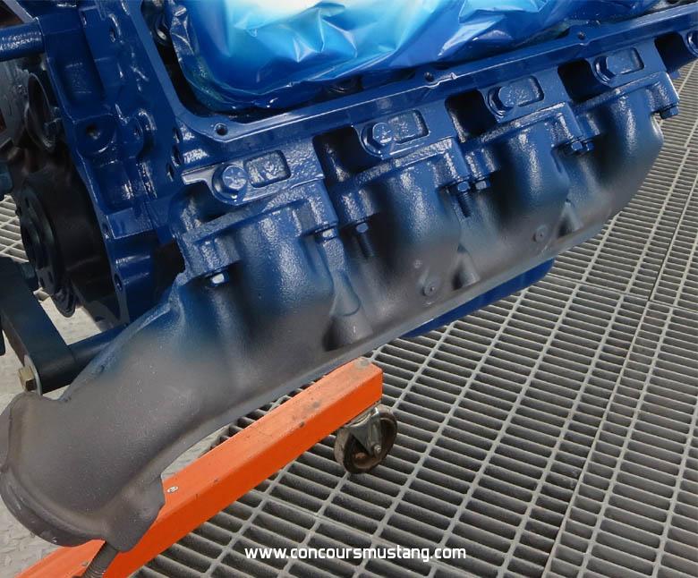

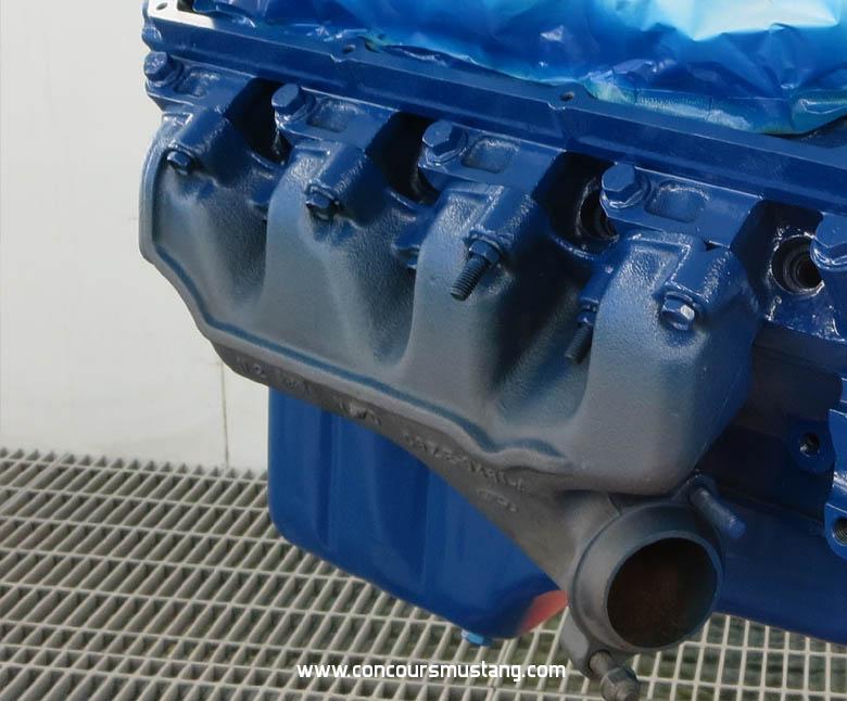

Took a couple of days to dig it out
And a few examples of the finished look
Offline 5F08KGT
  • Posts: 159
Re: Exhaust Manifold Finish?
« Reply #12 on: January 24, 2016, 09:24:58 PM »
Thanks Jeff!! I like that color and sheen the best!
What is the best way to clean up the manifolds prior to application?
