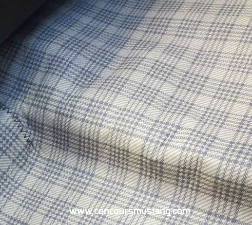

The shops have had difficultly finding a supplier that can provide one already stitched (we've asked a number of times) as it seems that the workers refuse to do the work due to the off gassing of the product after it is made. Just what has been communicated to use
Its only a compromise if you just want something you can pop out of the box than install in the car. Many owners and shops add the corner stitching to produce a reproduction much closer to the original. Done it a number of times not fun but allot more fun than allot of other tasks and its clean work ;)

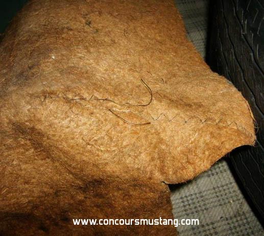

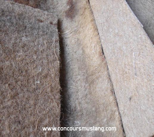

A couple of shots showing the backing/jute. Originals can take on a brown or goldish tone, possibly due to contact with other materials.
Three examples side by side showing some different jut backing from NOS and original

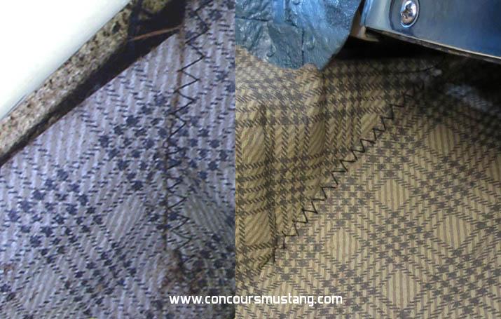

Not sure who made that specific mat - shop purchased it for a Dec 67 GT500 project I was shepherding from NPD I believe
I have been debating if I wanted to purchase the ACC Burtex mat. Did you have someone stitch the mat to make it look correct?
Like most projects I did that myself using a pattern I made after measuring an original. Guess I could put together an article of how I did it. Took pictures of the process, as I often do, so that I could sometime in the future.
 Comparison between an original and a reproduced stitch
