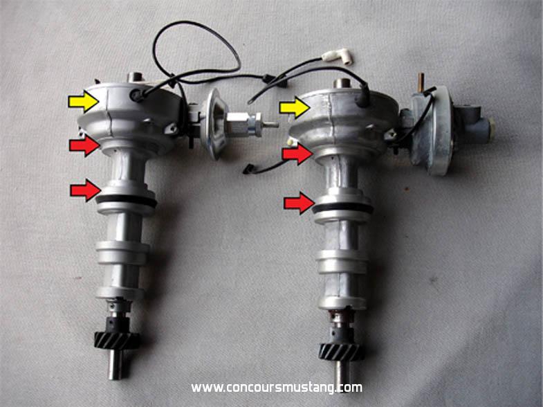

From an earlier thread. Dist on left is a NOS version with nice fairly consistent main body finish and the brighter machined edges/surfaces (red arrows). I built a hardwood holder to hold the shaft and use a drimmel tool to spin the case (with the vacuum advance not attached) to redo the machined surfaces as they often get chipped and scratched over the years and to get the fresh machine look of the original. Is helps allot if your starting with a good core and like other aluminum parts I have at times used the light acid aluminum wheel cleaners for the main body (yellow arrow) before the detailing
I'll try and remember to drag out a few of the NOS distributors and take a closer shot of the machined surfaces as they don't show up in the picture below as they do in person

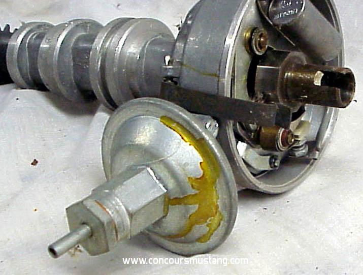

+1 Would call the pin more of a greenish/gold finish similar to ported vacuum switches, Thermactor T fittings and back fire valve main bodies. Finish didn't hold up well over the years. Examples are NOS (not rebuilt) units boxed in 1968 or 69
Mounting screws depends on what year as you can see in the pictures below
Advance attaching hardware P & O
Advance attaching hardware zinc. (Don't just copy the paint marks - they likely don't match the ones that should be on your car -  :o
