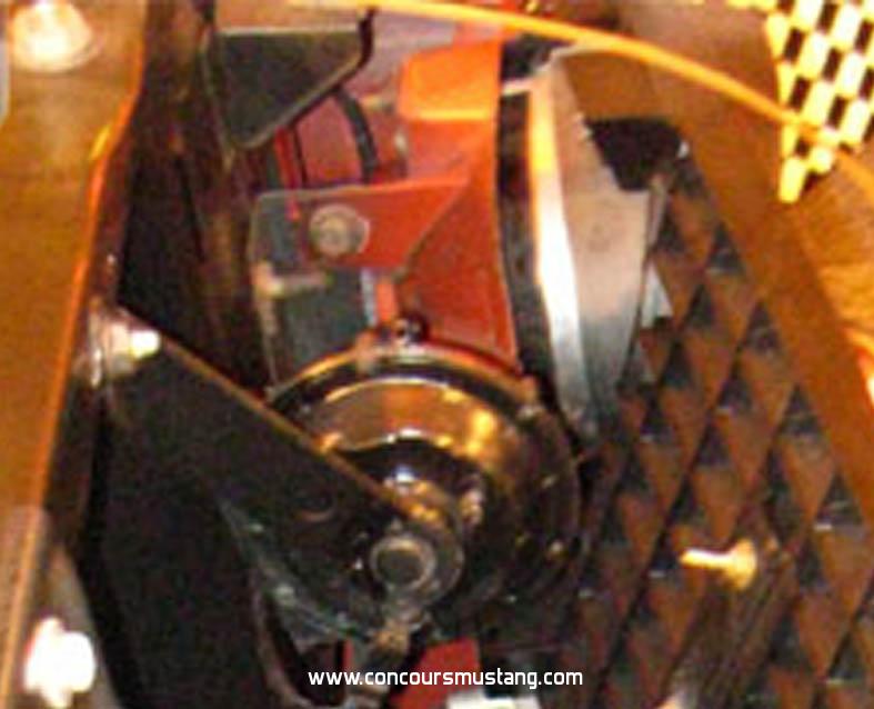

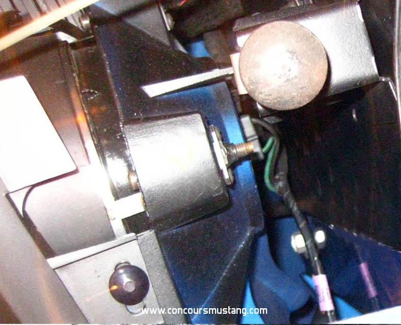

So sprayed example. Likely choose too many examples but here they are. Faces around and in the inner headlights were the focus - the amount of over spray on the back side can vary as you can see
9F156xx

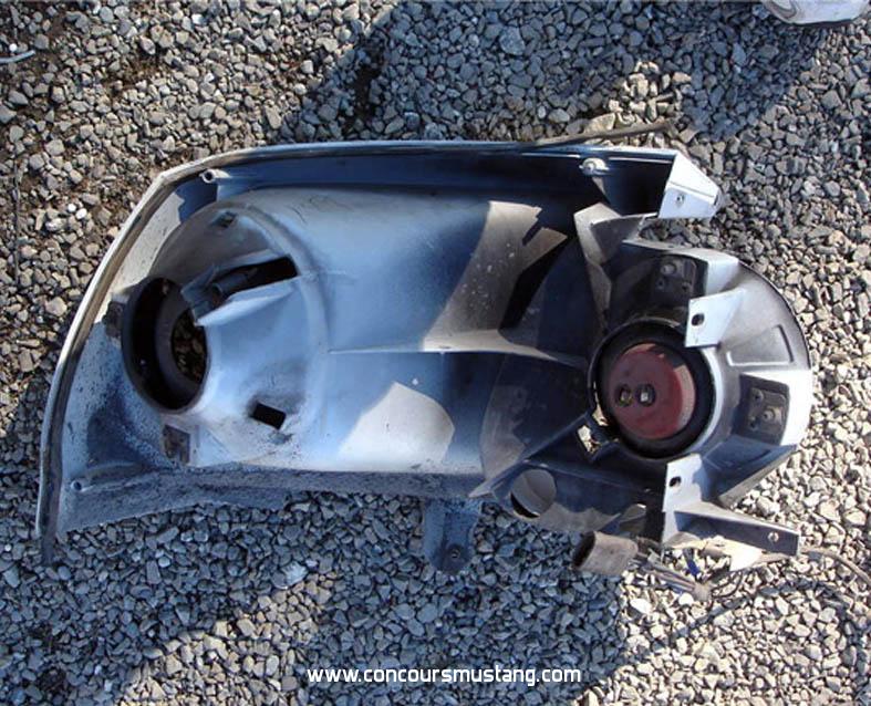

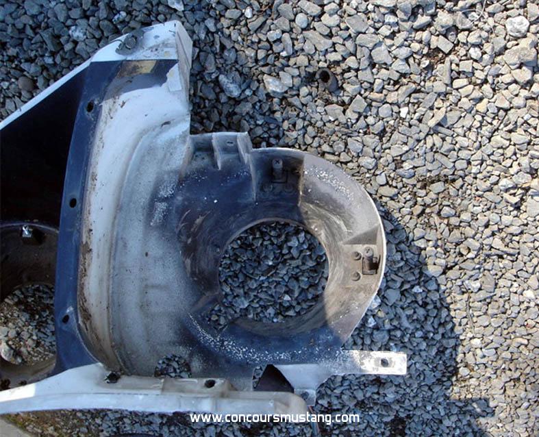

9F2169xx You can just make out a little black overspray/misting on the mounting area

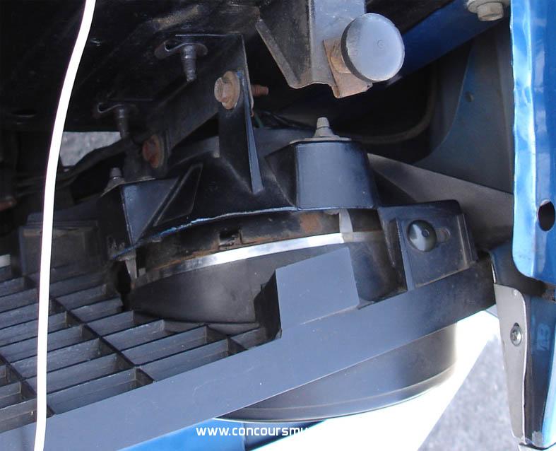

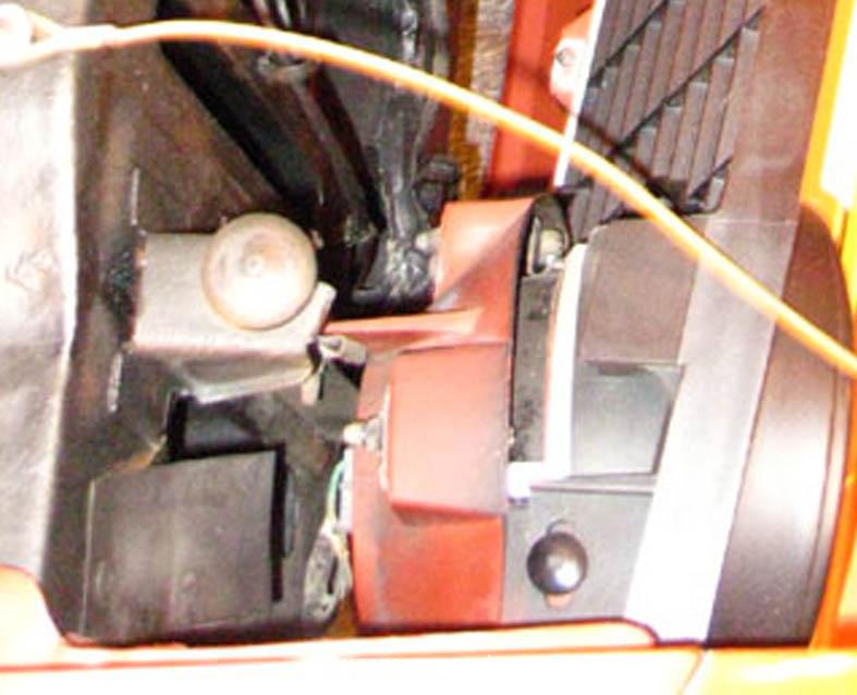

9F21697xx

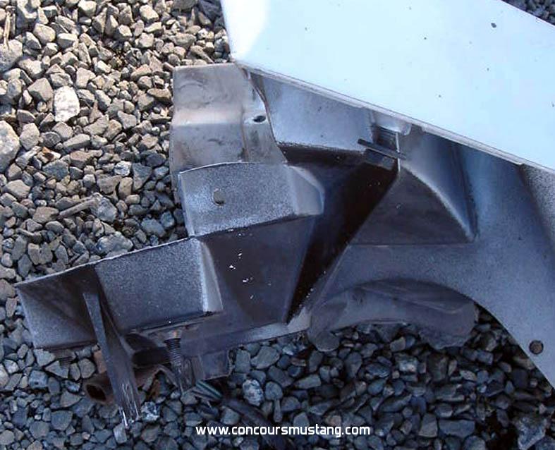

9F2227xx a Boss 302 example so ignore the blacked out outer headlight

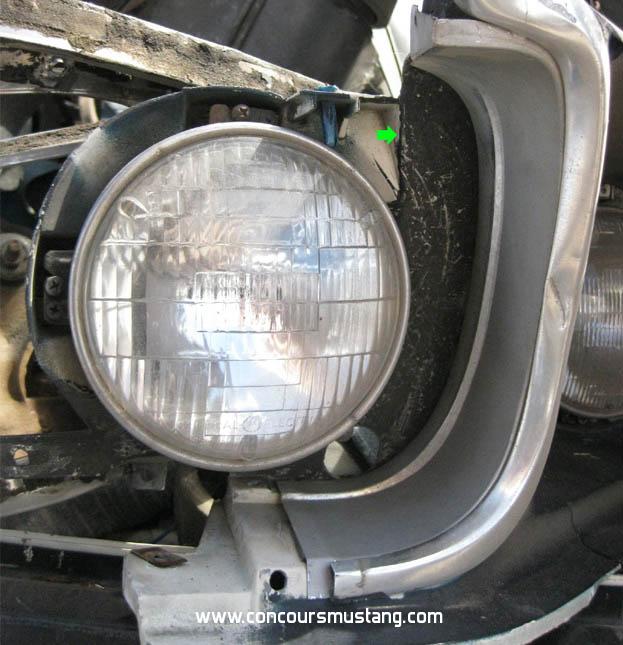

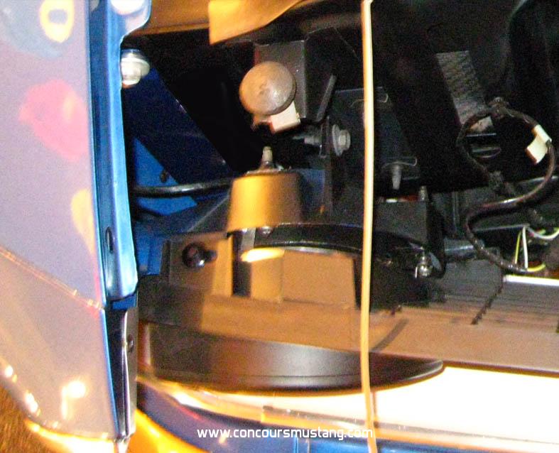

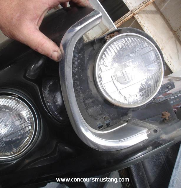

Couple of examples on dark exterior color - in these examples Black Jade and the black out. Amount of sheen is the key when looking at these dark picture
And a brushed example -
