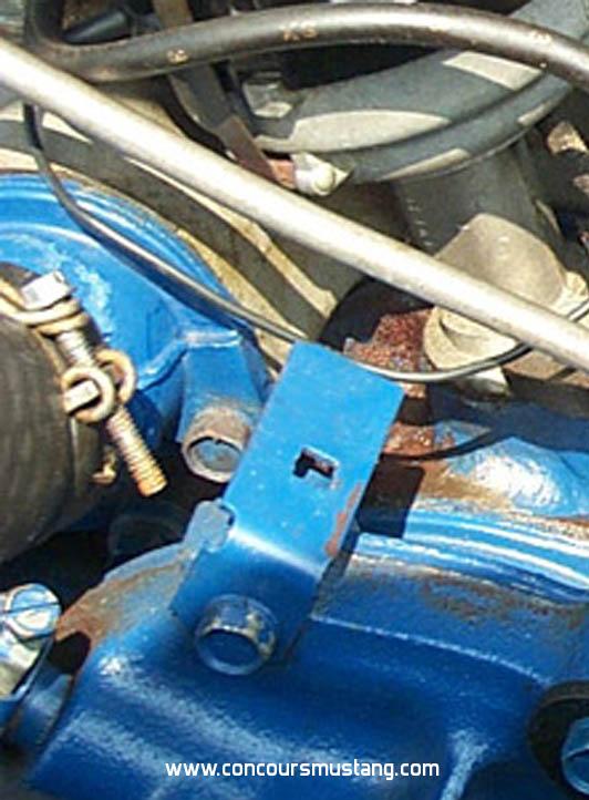

« Reply #6 on: March 01, 2016, 02:29:46 PM »
An example from a unrestored car

« Reply #7 on: March 01, 2016, 06:43:20 PM »
A much less known nuance detail is the bypass clamps. Jeff's picture illustrates the use of a special size clamp for the by pass hose. the special clamp installed at the Cleveland engine plant (unlike the heater hose clamps installed at SJ in this case. It has narrower band smaller and different size smaller thread but with same size hex head as on the heater hose.

« Reply #9 on: September 28, 2018, 03:15:32 PM »
I was searching for something else and decided to revisit the 67 Shelby posts.
In the photo above I see what appears to be the newer style t/c gasket. You can see it just under the dipstick bolt.
I thought assembly line gaskets left out the additional material you see here?

« Reply #10 on: September 28, 2018, 05:02:09 PM »
Not unusual for a water pump to have been changed out or a timing chain replaced on a 40+ year old car. Don't believe that color picture was a period picture from 67
