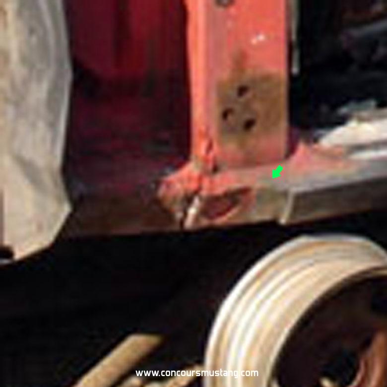

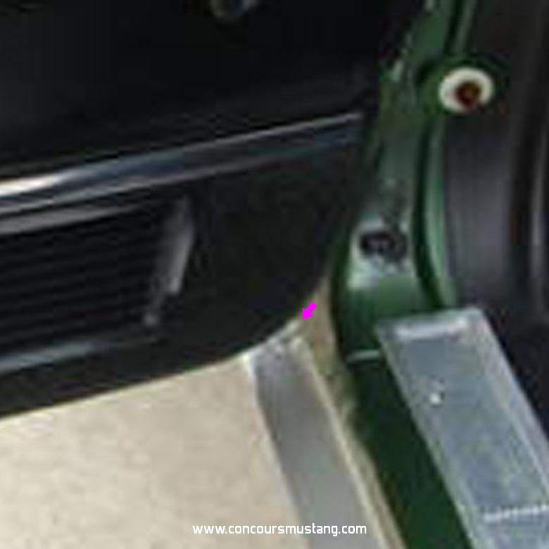

Like I mentioned before not allot of pictures but here is what I found
Appears that on the A pillar and forward rocker the painter just faded down and away and did not extend the color (black of silver all the way to the first edge fo the pinch weld as they would have on a car without the lower paint details

Thanks for pics you posted. Very helpful, do you know the year of car without fender and the white car?
Re: Silver on rocker panel 71 Mach 1/ Jeff
« Reply #5 on: March 25, 2016, 03:54:52 PM »
Looking back to my files - they were the best I could find showing the detail - both 73 Dearborn build cars with the painted lower section
