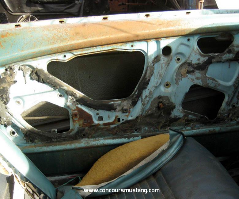

Most places don't go really in depth restoring the inside of the doors. if you strip the doors the sealer placed between the outer inner skin can't be replaced without disassembling the door. The sealant really isn't visible inside or from the exterior just was sandwiched between the two panels
Also the sound deadener was applied when the outer skin was not attached so reproducing that surface can be very difficult if you want it ti look exactly like what it did originally
Of course originally the interior of the door didn't get much paint to the back side and very little to the ends and bottom surfaces and little if any to the inner structure.

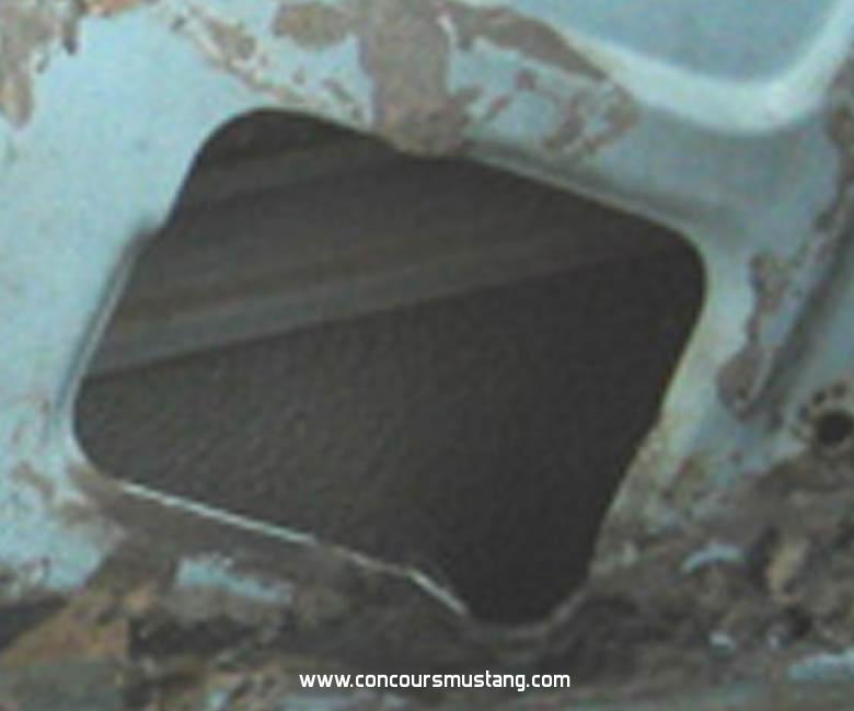

For the discussion a couple of pictures - sorry only has a 68 door at home so had to rely on pictures taken
Notice in the closeups that the sound deadener goes behind the horizontal beam and no sound deadener on the beam
