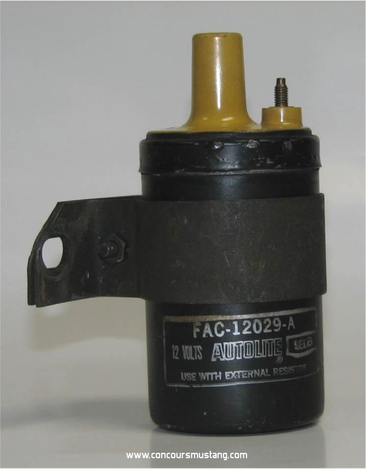

.............Will an original have the yellow top? P/N stamping?
Yes all yellow tops
Paint number is ink stamped on the coil base  - stamp includes AUTOLITE and a date when the coil was built
In this example FAC-12029-A 9EDB
More importantly, it's currently on the intake? Is that the correct mounting position or should it be front passenger side of block?
Drivers side fron of the intake pretty much like where 68-69 390 and CJ's were Guess that way the wokers only had to learn and remember on location  ;)

Typically the way the coil is indexed in the bracket you can hardly see the outline of the stamp let alone the date code.Many times it is smeary which adds to the difficulty to read even if it was visible.  It is kind of a waste of time IMO trying to search for a date coded coil unless this is a untouched survivor car that needs a part with matching patina. Most clean and repaint the coil before sending out to someone to have a appropriate date coded stamp put on . I get 35.00 others less some more.

Also notice the difference in the two brackets - the '67 is reinforced with a formed center piece welded to the strap. The '69 does not have the reinforcing piece. I mention this because Jeff's photo with the stamping example shows a '69 dated coil. I don't know when the transition occurred from the reinforced type to the simpler type, but I believe you should have the reinforced style for '67. As a side discussion, I would be grateful if someone can confirm which style was used in '68.
The article mentioned is taken out of context. That was for a 68 with smog and is the way it is typically found in that application. It is not for every application.  The comments you made on the strap is missing information that is relevant in this case for others who may be reading. In this case the reinforcement on the bracket or not has to do with a thermactor application . It is more about application then it is year in this case. If it has thermactor the coil bracket is bolted down on top of the thermactor bracket strap . The strap gives the extra support so in this case the coil bracket doesn't need the extra reinforcement. That is the way ideally it was engineered to be in the case of BB thermactor . Anomalies happen so it is not absolute . No thermactor on the BB typically called for a reinforced coil bracket.  FYI the BB coil has the notch to index the coil to the notch in the BB manifold casting when bolted down. SB is the opposite.  Jeff's picture is of a typical BB coil bracket notch.

While we are on the subject of indexing I thought I would mention that the BB coil in Jeff's picture is a little too far forward form what is typical on a thermactor engine installation. The way the coil is positioned on the intake makes indexing the coil body in the bracket typically farther back. The strap to the thermactor tube is indexed in such a way as to only allow the coil to sit so far back in the bracket without bottoming out against the thermactor strap.

The corner missing in this pic and Jeff's is the notch you mention ? Is the reinforcement a 67 thing too as my 67 390 with thermactor has a reinforced coil bracket.

Yes it is a 67 thing also. It is up to you to decide the way you want it on your car. The way it was engineered vs. another way. Like I said previously anomalies happen but explaining them can be difficult and frustrating sometimes. This is a nuance detail and once mounted not something many think to look at or even know about. It is especially hard to see on a thermactor car with tubes in place.
