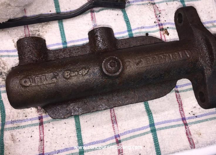

So who manufactured the master cylinder? I'm assuming it wasn't Ford. And what casting numbers or markings can we expect to find on the original proper units? Is there a thread somewhere discussing all this?

Bendix was the OEM supplier.
Think we need to specify or maybe split the topic since I think we're getting two or more of the master cylinder comments, findings and details over lapping one anoth. Will look to see if I can separate the two to reduce the possible confusion this may create
+2 On Bendix and your casting information on the bottom of the main body would be different if it was a power disc brake or drum unit along with other details.
Markings are cast into the main body and visible from below the master cylinder the location and how they are arranged differed depending  on when they were made.
Here is a likely 68 example (came out of a reported 68 San Jose car) though its very likely NOT a drum brake application, just to show the details
To the left the Julian date code, the Bendix logo, then the identifying Bendix number
« Last Edit: July 15, 2022, 12:23:16 AM by J_Speegle »

So here is the bottom of my master cylinder showing casting number of 2227451 and what appears to be a date code of 328
Is the date code decoded as March 2, 1968 or is it a Julian date which would mean it's a November date?
That being said, I think my cap should look like the one pictured here too.
I look to anyone to help confirm this for me. Thank you.
As stated believe its a Julian date. We see a change from traditional (or what ever its called) to Julian during 66 production as shown and discussed in another thread and in the article on date coding in the Library
Do not think it is original because there is no screw in the bottom. Most likely a service replacement.
