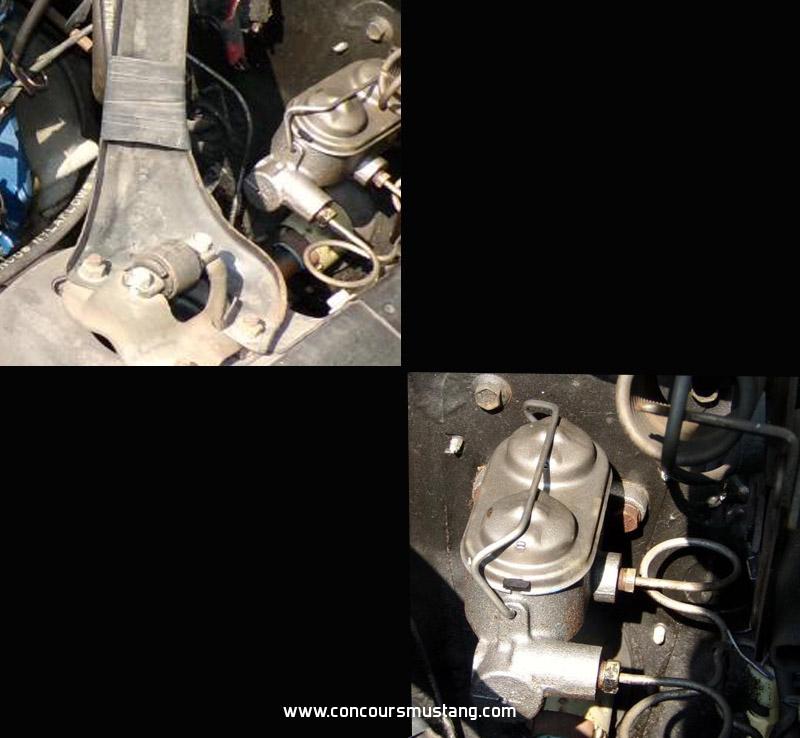

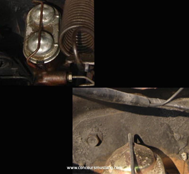

It has been mentioned how paints don't stick well to plated finishes when compared to bare metal. Same can be said of aluminum
Also did notice in my pictures there are a fair amount of new (NOS) caps on cars. Fairly popular update for owners. They were cheap and looked much much better
Couple of pictures showing style and in some cases black paint still visible. Plenty of rusty, old looking ones I choose not to post at the time
From one of the examples in the Unrestored Picture section

IMHO manual brake master cylinders were natural cast and the lids were zinc dichromate. This is what I found on our 68 unrestored San Jose car.

It is my understanding that the lids change from zinc dichromate gold to silver zinc was a early late 68 transition.

Looking at the pictures posted by Jeff, and according to Bob, it does appear my lid and possibly master cylinder is not the original or at least the cap was changed. So at least I could get the proper cap. Any suggestions on who has this cap in either the silver zinc or zinc dichromate version?
