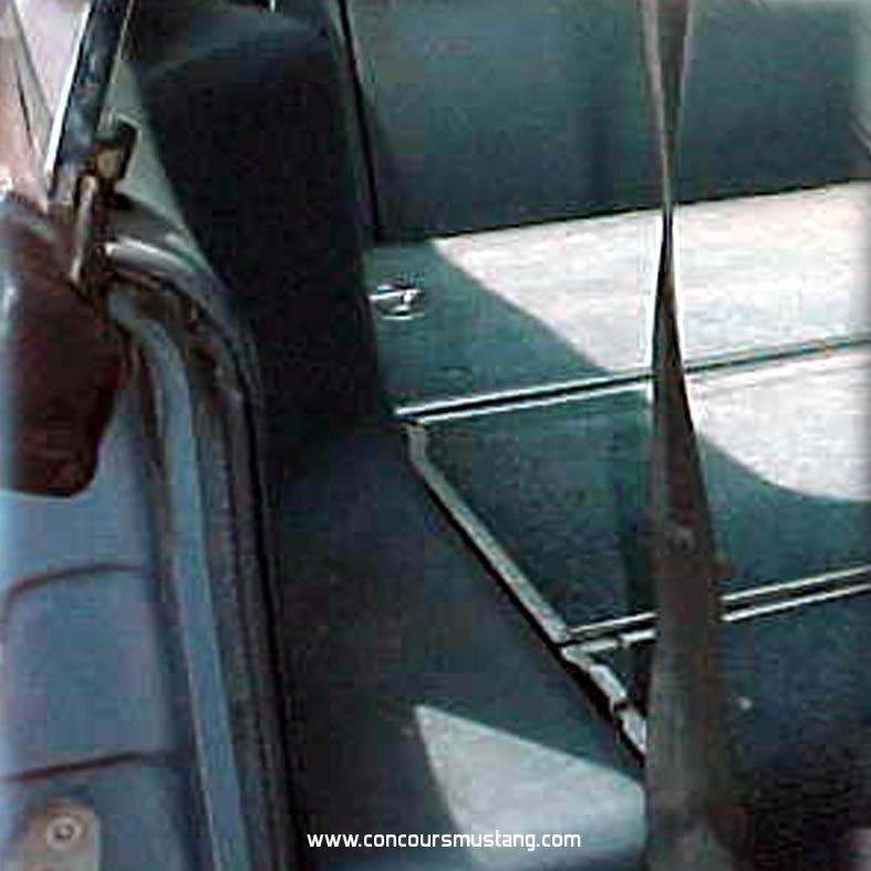

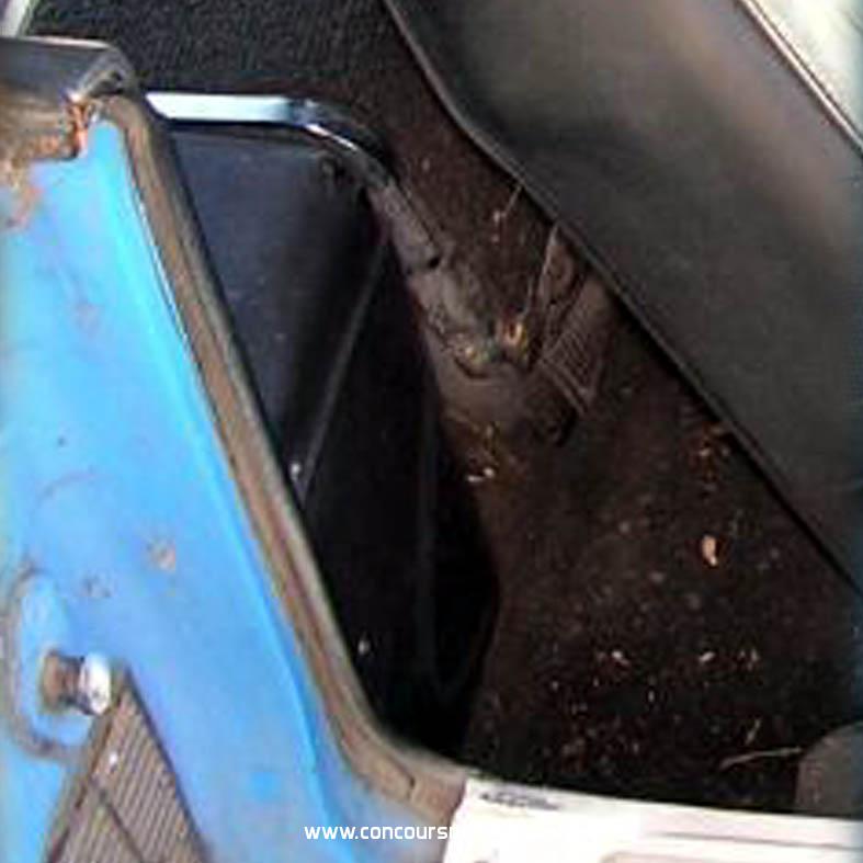

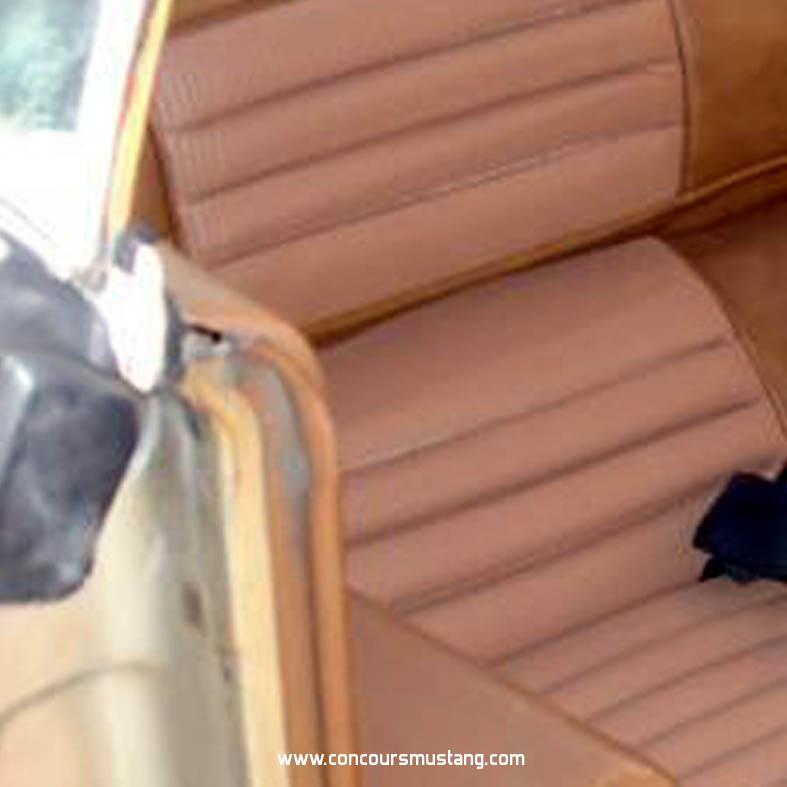

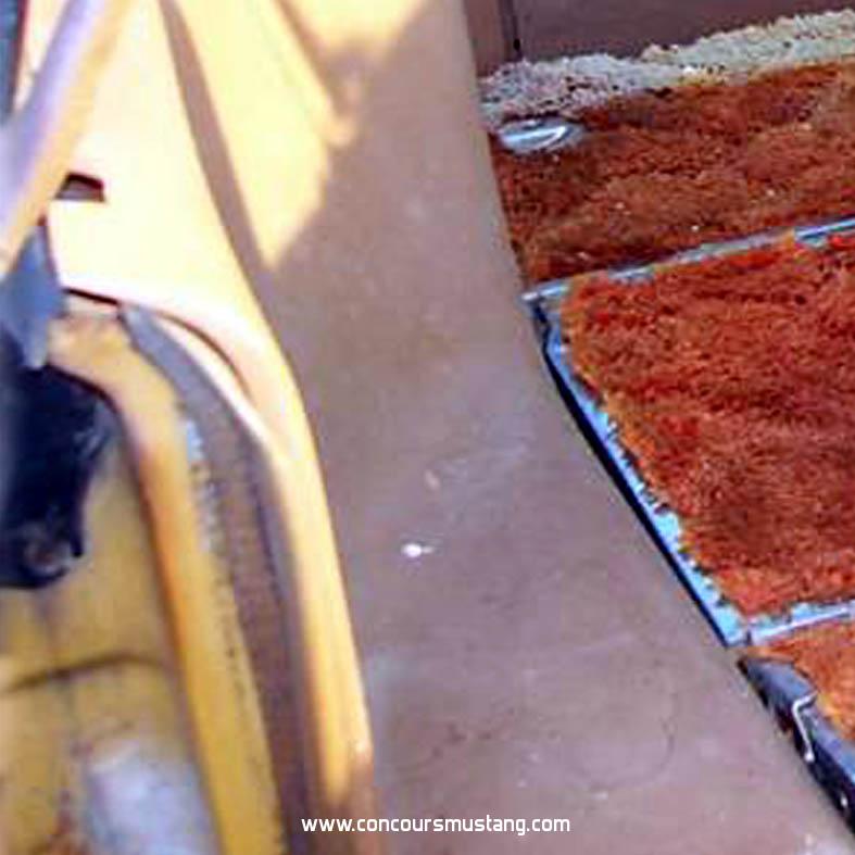

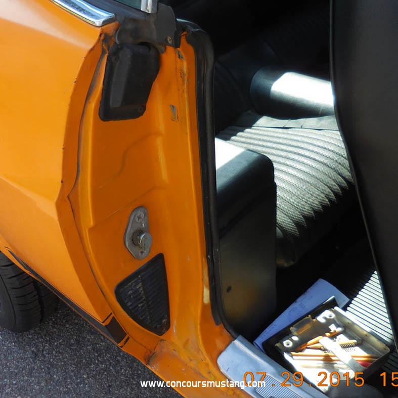

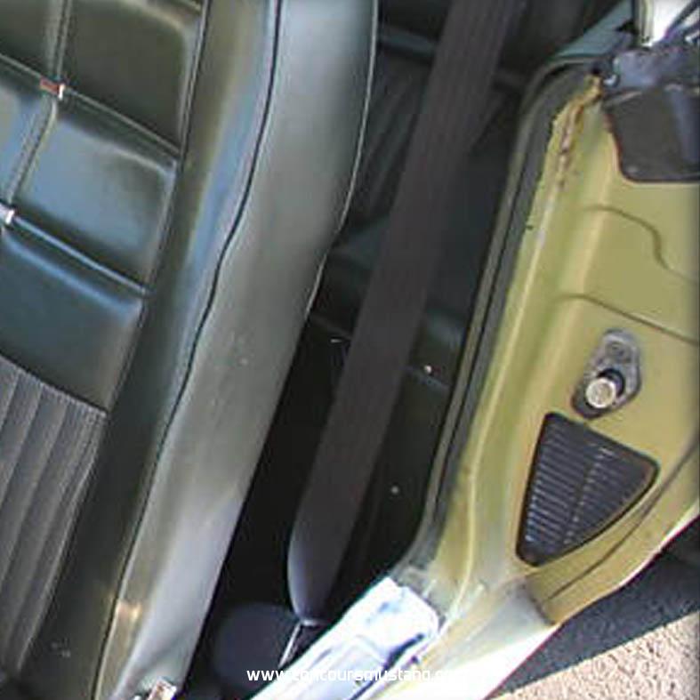

Looks like the general idea was for the top edge to smoothly transition behind/between the door edge and the interior panel rather than have the end create a sharp 90 degree edge at the top. How much the transition takes is up to you to determine. Tried to post pictures of cars that were not repainted so that the interior panels were less likely disturbed. Did find a couple of ones with the sharp upper end but in the minority by allot
At the bottom is simply travels between the door jamb inner edge, the lower edge of the interior panel to beneath the sill plate
If you need more pictures have them but this should help
Shown from early in the year towards the end of the year
