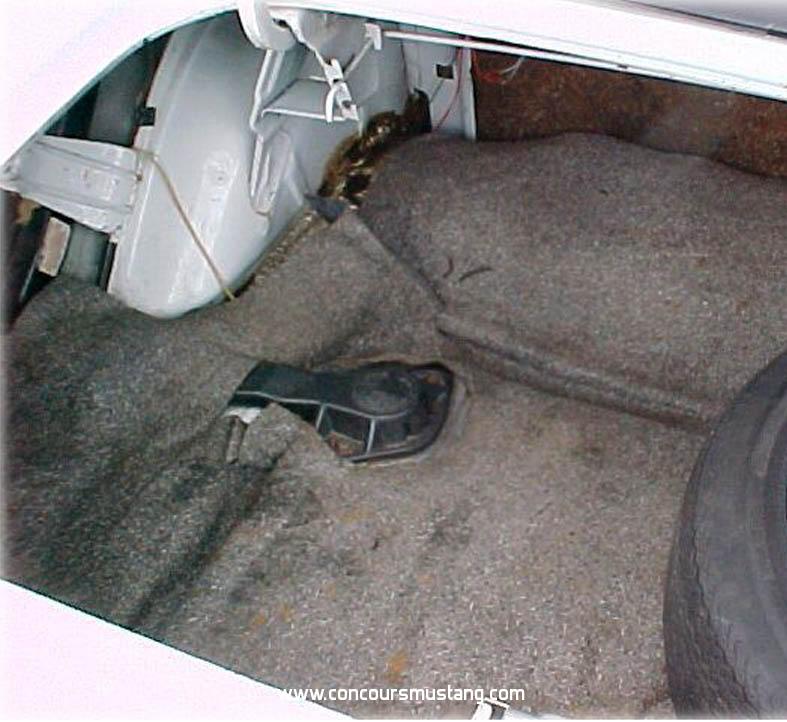

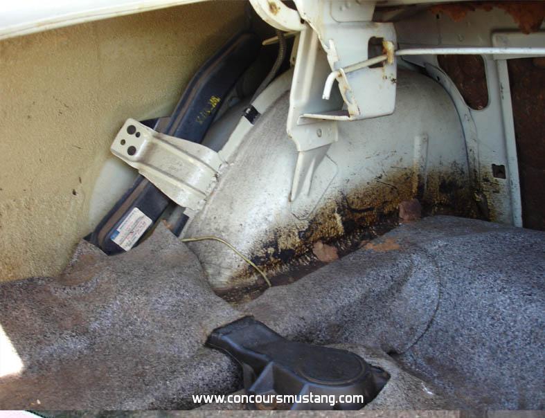

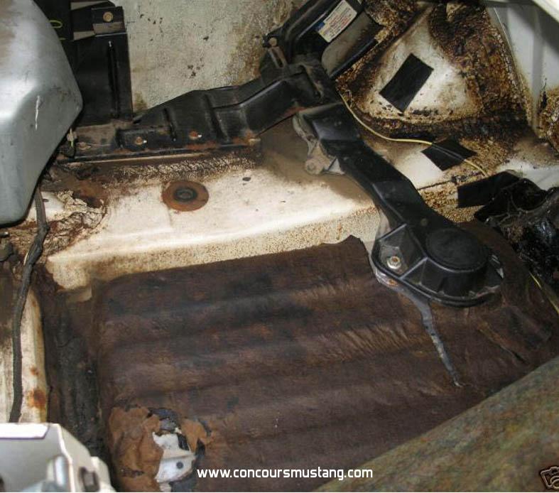

In any case the cut outs for the underlayment and the mat can differ between the two plants. Though I have found plaid mats in 70 San Jose cars the speakled still seems the vast majority of the finishes
Here are you two 70 San Jose examples. Underlayment size and placement will differ between standard coupes and Grandes
Also as an extra :) the drivers side pinch weld does not use the regular rubber protectant strip but instead is uses two very short pieces of windlacing instead. You can see the upper on in the picture below the evap mounting arm welded to the wheel house and one behind the other plastic vents near the taillight panel

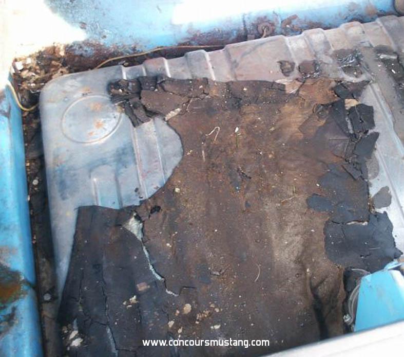

Depending on what model the car was but it appears that all models got the underlayment over the gas tank section at least. The original material had a "punch out" area in the mat design. You can find examples of underlayment in cars with out California emission systems with that section missing as shown below. On coupe models such as Grande's the underlayment is larger and covers more than just the top of the gas tank
Sorry no original examples handy here to get a pattern from  :(
