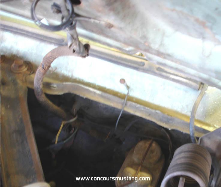

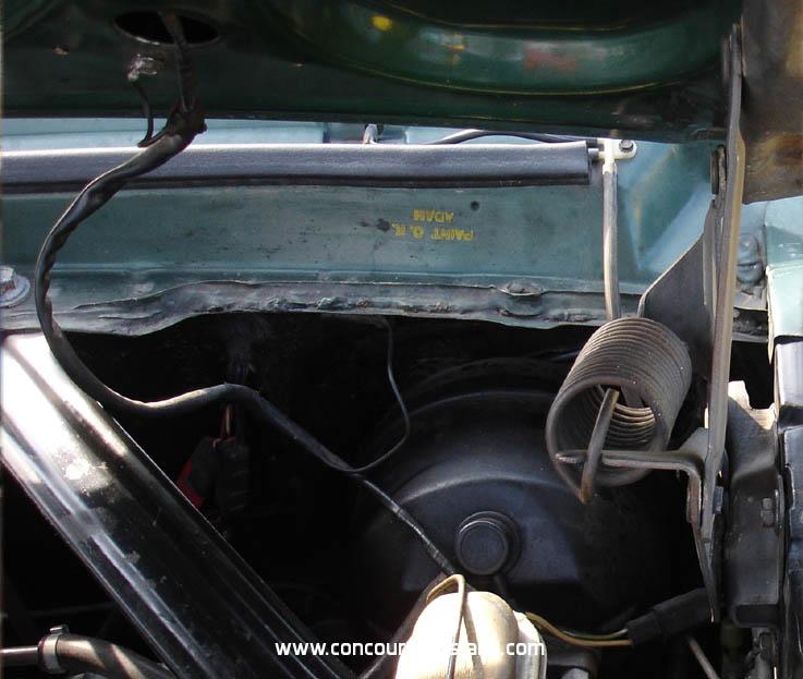

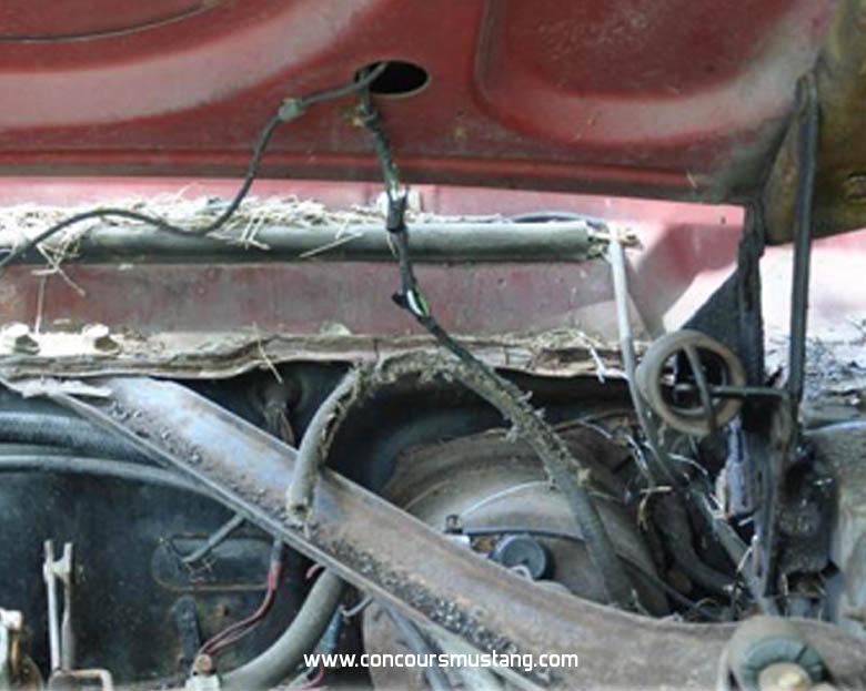

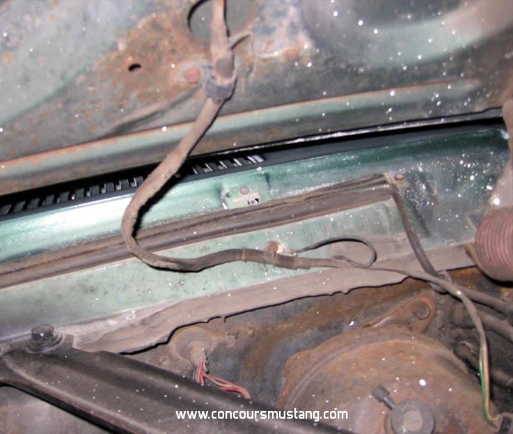

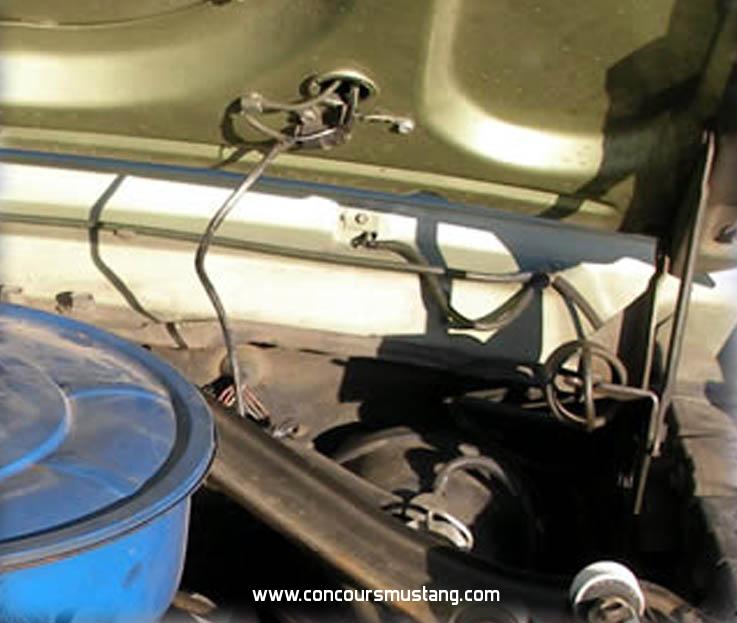

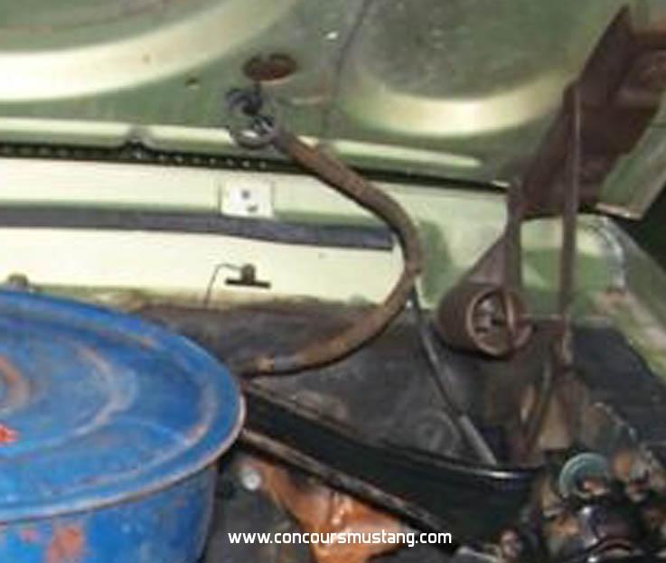

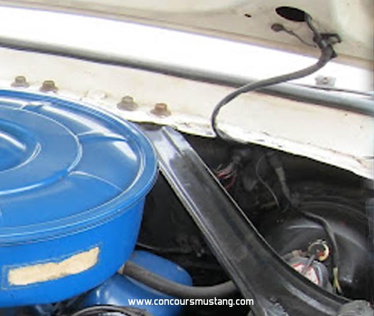

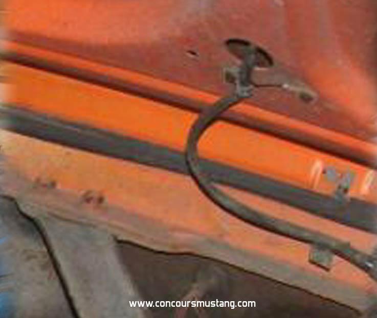

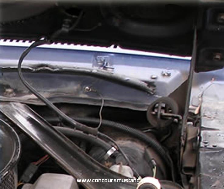

« Reply #6 on: May 11, 2016, 05:36:56 PM »
Most of mine are from too great a distance to show detail and of course close ups are of worn aged part :(
But here are still a few that might provide some part of the puzzle for you guys working these details out
DEARBORN
7F1291xx
NJ
7T260409
7T2609xx
San Jose
7R1153xx
7R1390xx
7R1518xx
7R194xx hood
7R2391xx
