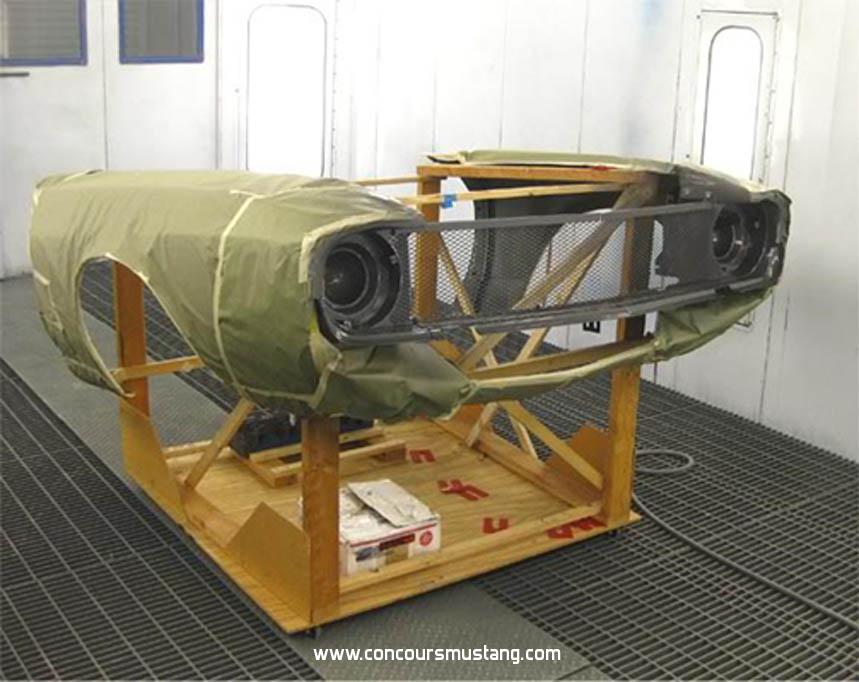

I am installing the OEM headlight buckets, front valence, and a correct reproduction fog light support on my convertible.  As this car is just a driver, I am doing this project with the fenders attached to the car.  However, I am trying to do it as close to original as possible.  Through researching many sources, I've created the below list of paint colors for various front end parts.  Please make any corrections for colors/info I have wrong.  I am trying to get this right the first time.  Thanks.
Argent:
Screws holding headlight bucket to fender bracket.
Screws holding mesh grill to fender bracket.
Fender bracket.
Front of headlight buckets, mesh grill and support
Top of foglight support
Semi gloss black:
Hood twist hold downs
Paint line on fender between eyebrow and radiator support
Underside of foglight support
Back side of mesh grill
Inside of front valence
Unpainted:
bolts of hood twist hold downs.
bolts, washers, spacers holding headlight buckets to radiator support
Body color with incomplete coverage:
Bottom and back side of headlight buckets.
Some body color shows through on underside of headlight buckets below eyebrow.

Making progress on this project.  It took me a lot of time to get the headlight buckets and eyebrows to fit correctly.  I have a new appreciation for the 69 shelby fiberglass front end after assembling one.

Remember for a authentic factory look all of the white nylon inserts would be painted the gray during the process also.  You can still see some of them if unpainted when looking at the headlight /grill area.

Thanks Bob.  I will correct that.  Did I get the black out around the turn signal correct?  The paint was wet in the below photo.   Let me know if anyone sees anything else I overlooked.
I got it back together and drove it tonight.  It was a bigger project than I anticipated.
  • Posts: 9523
Re: 69 Shelby Grill Area Colors
« Reply #5 on: May 26, 2016, 05:10:39 PM »
The paint on the valance looks too glossy it should be a semigloss. I am hoping that the gloss is from the flash. The bumper arms of the chrome front Shelby bumper were blacked out also.
