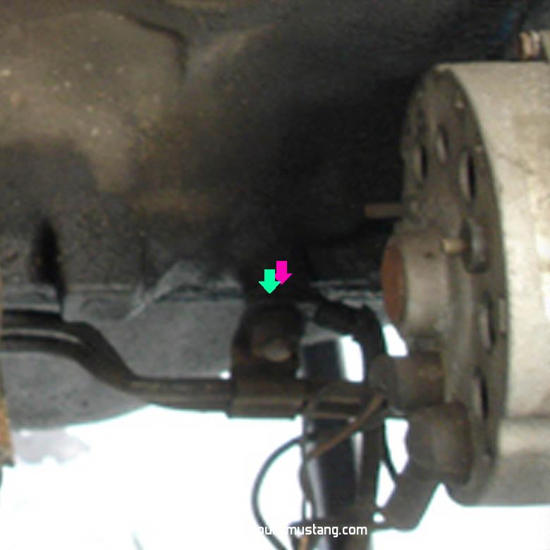

Here is a picture of a San Jose 6 cylinder with automatic at the ground attachment point. The ground cable  (purple arrow) from battery is sandwiched between the transmission line retainer/clip  (green arrow) and the block. The block has a stud screwed into the block attachment point and a start washer and nut is used to hold the wire and retainer to the block.
Ignore the aftermarket alternator
If your coming up short you might want to look how the cable is routed up at the battery area

As a discussion point, would the stud first be used to retain the transmission cooling line bracket, then the alternator and battery grounds? (Order of parts from engine block: block, bracket, lockwasher, stud, alternator ground, battery ground, lockwasher, jam nut.)
