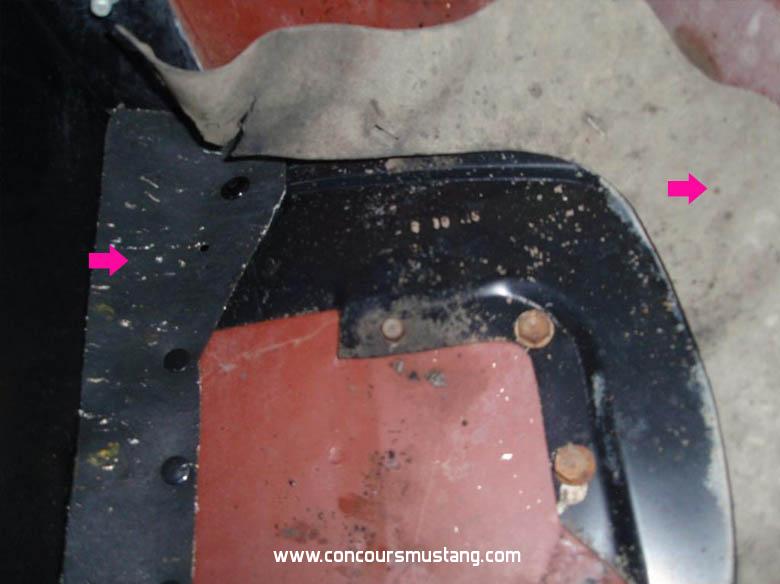

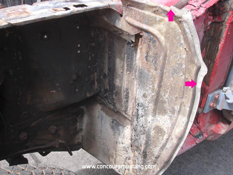

Originally its pretty thin rubber sometimes with reinforcement threads running through the material
Used front and rear. You didn't provide what year, when it was built or what plant your car is or we might be able to provide more info. As you can see in this mid year 67 San Jose example the front sections are different in the material they used on the top (picture) example . That material looks very similar to the material used to make the rear license plate light shield that attaches to the taillight panel under the bumper though thinner
In the picture of the rear splash shield originally the seal material would have been attached the complete top edge - it appears this car lost that at some point or when the fender was removed

« Reply #10 on: May 28, 2016, 01:40:44 PM »
I have an additional question concerning the second picture that Jeff posted...
Would the black paint used on the splash shield guards be the same black paint as used at the outside off the engine bay/aprons?
To put it otherwise, if you look at the same picture (in originally state), would it be all the same black?
Thanks for clearing this out.

« Reply #11 on: May 28, 2016, 02:19:12 PM »
kind regards,
Jeroen
It could be but since originally the shields were painted at a different location ,different conditions with different materials the odds of it being 100% the same are remote IMO . I would make them slightly shinier then the engine bay or aprons but that is just me.
Re: Inner Fender Splash Guard
« Reply #12 on: May 28, 2016, 03:18:14 PM »
I have an additional question concerning the second picture that Jeff posted...Would the black paint used on the splash shield guards be the same black paint as used at the outside off the engine bay/aprons?
No. For your year and plant they were painted off the car as Bob wrote and are generally (from original examples) were a glossier black that might be a result of how the paint was applied plus the source of the paint was different or at least a different batch. Compare the finish on the front splash shield in the picture provided above and notice its finish. Same provider as the rear much of the time
