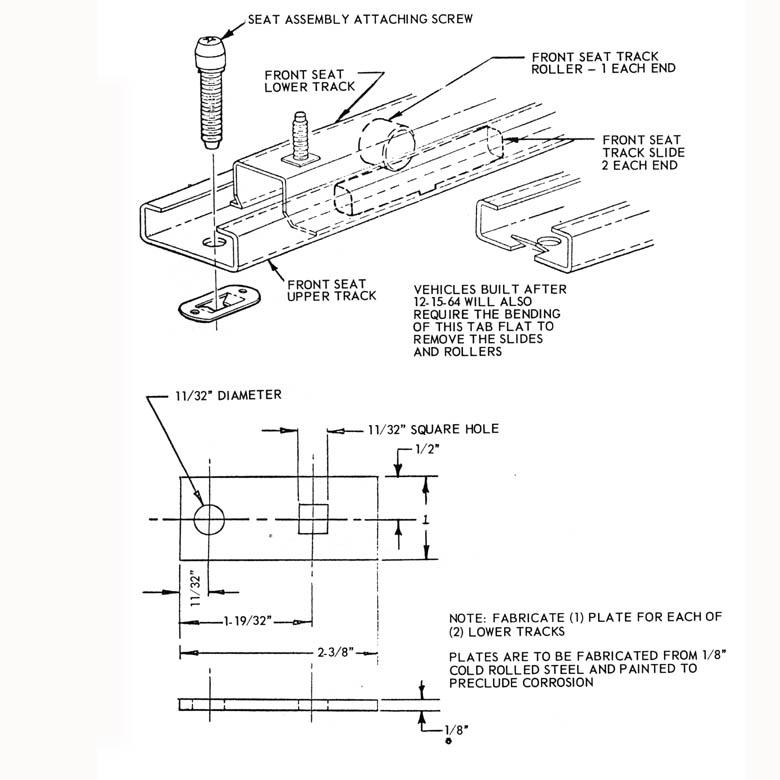

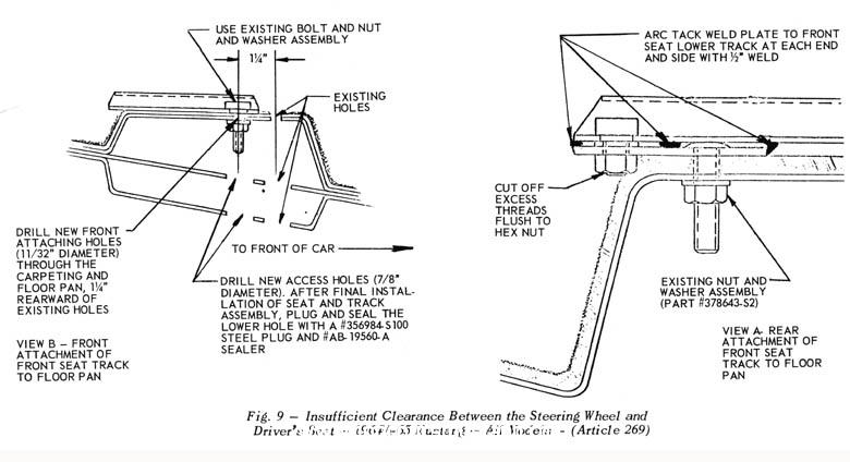

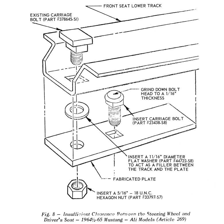

Seen a number of owners make a new bracket that goes between the original and the floor (would require two addition holes in the seat risers for each seat)  that would set the seat rearward a few extra inches (far enough so the rear stud is rearward of the seat riser). I can not recommend just out of concern for liability reasons for myself and the site
There was a dealer fix for the problem which moved the seat rearward in a TSB article #269 as shown below
