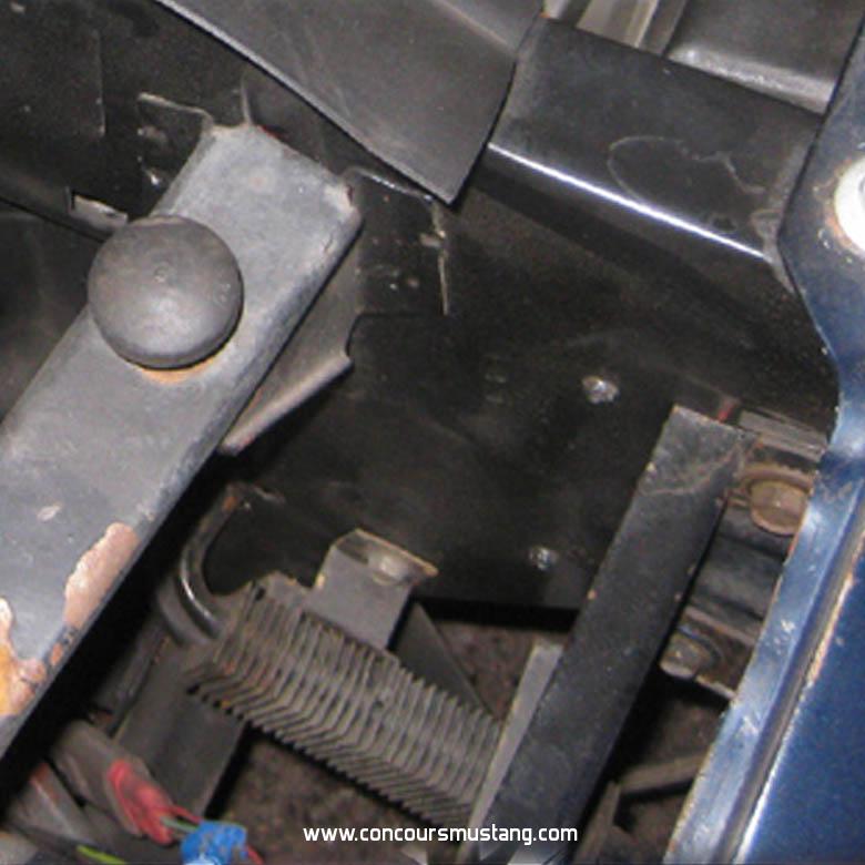

Guess its my turn :)
PS hose routing
Cooler location and hardware
Upper clamp is the original style lower is not

thanks for the replies.  Does anyone care to share some pics?  Where does the cooler mount?  I didnt see anything about that in my Shelby assembly book.  If it routes the same as a big block does it also use the big block mount and insulator?  Thanks!
It uses the same hose mount insulator and bracket as the BB mounted by the lower control arm if that is what you mean. The P/s cooler is mounted on the front side of the radiator support . two holes are cut into the support for hose routing . Additional bulk P/S return line hose is added to connect the cooler to the system.  It is run in series between the P/S pump on the one side and the return line from the control valve on the other.

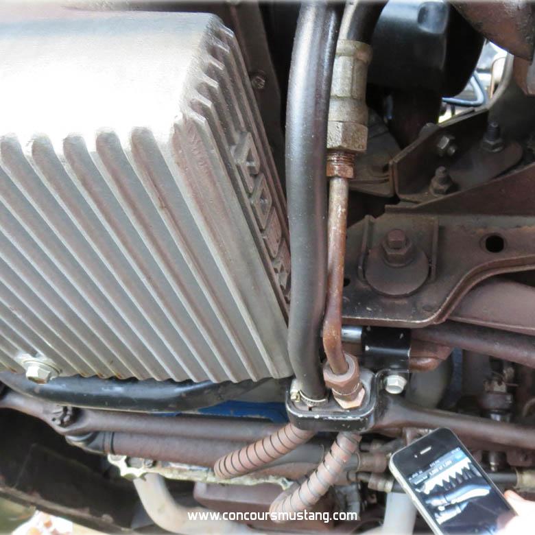

note bottom pic shows unrestored 67 car & clamp on control valve is worm drive  must be a late car   anybody note when the strap to worm drive clamp chang e over started in 67 cars?
Last year I worked on original SJ 289 Mustang P/S system with the strap clamp that had date stamp of March 2, 67 (date code of 7C22A on the PS Cylinder)
Small pressure line fitting too (1/4" flare nut)

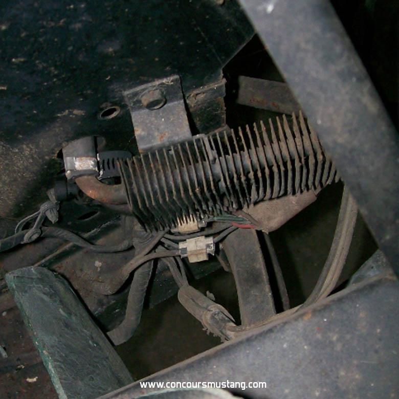

« Reply #12 on: May 29, 2021, 01:55:52 PM »
Tagging onto this old thread as it's very appropriate.
When I took my car apart I actually snapped a pic of the crimp connectors at the cooler.
See pic.
Looks just like the version Bob posted earlier.
Did Ford perform the cooler mod or did SA? I'm guessing the later based on ugly holes and non-factory style crimping.
Anyway, I have NOS non-dimple crimp clamps for use at the cooler (in and out). I'll use diagonal cutters (or a crimper without the center piece that prevents the foldover) to crimp the clamp.
What clamp style is used at the break in the two part return line from the control valve? Crimp or screw (see pic)? If crimp, same non-factory method?
What clamp style is used at the pump? Crimp or screw? If crimp, same non-factory method?

The cooler addition was done at Ford assemblyline apparently given the photos of the units at the airport lot prior to Shelby conversion with cooler installed. Crimp clamps were used at the pump and return line. 68 Shelby changed to the screw clamps in your picture at the pump and the return line. The hose was pushed on almost the the elbow of the cooler . The hoses were installed on the cooler and then the hose was fed through the holes. The crimp clamps are installed far enough forward that they are on the front side of the radiator support once installed . That was most likely the reason why the hose was push so far onto the cooler tube.
Re: 67 Shelby power steering lines
« Reply #14 on: May 29, 2021, 03:02:07 PM »
Thanks Bob.
Those are some nasty factory holes!
