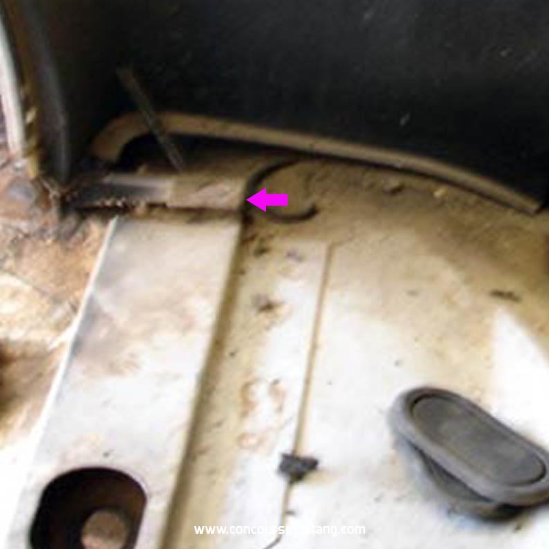

If you're in a hurry, you can opt for the cheap email Marti Report.
Check for the brackets spot welded to the floor pan to receive the screws shown in the chrome inserts.

Believe you will find that the brackets your referring to were installed on non-fold down sportroofs/Mach I's/Boss's
Just for the record that's not the rear panel for a 69-70 fold down application

« Reply #4 on: July 09, 2016, 12:24:28 AM »
Your first picture seems like the view of the bracket I remember seeing on my car.
What's attached to these L & R brackets on fixed rear seat cars?
Got to be something otherwise it doesn't make sense for Ford to install them with assembly line cheapness being the order of the day.
Certainly a bonus for fold down conversions if all sportsroofs were so equipped though.
The panel is in fact a 71-73 version.

« Reply #5 on: July 09, 2016, 12:31:08 AM »
If the car was not ordered with the fold down option the brackets remained unused as shown in the second picture (same bracket as in first picture). Notice the package tray above and the bolted in rear seat panel. In 67-8 they hold the rear masonite panel in place on the non-fold down cars
