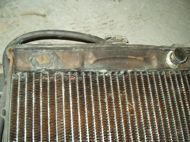

So i just took a closer look at the one i have.  It has FoMoCo stamped in the top tank.  But it looks like there was an inlet on the drivers side of the tank but a patch was soldered over it and a new one was added to the passenger side.  Is this some one did later on?  I cant understand why.  It makes no sense to me.  I also have only that portion of the build sheet which shows a C7ZE B radiator.  Would i find that part number somewhere on the radiator?
Ill try to get pictures tomorrow. Unless some one tells me this is normal.

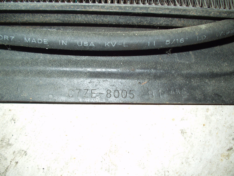

The part # is on the side rail drivers side, you should see it unless there is rust. I would let your local radiator shop look at it and see if it can be recored.

Thanks for pointing me in the right place.  I found the part number it has a 1 on the end which isn't on the build sheet.  Also has a date code which seems to match my build date.  Here are some pics
I still dont understand this spot which looks like a patch on an old inlet.  Should this be there?
As far as re-coring.  What exactly do they do?  What is the benefit of having it done.  I don't think the radiator leaks nor does it seemed clogged.  Probably could be cleaned though.

At least we know it's your original radiator.... it has had some extensive work done on it... and doesn't look very good...... When you get one recored the section you see where the hole has been patched up and other hole remains will be removed, the fin part is removed and bottom top section of bottom tank. You are left with the 2 side rails with the part #, the top section which has fomoco stamped on it and the lower bottom part, the fins and bottom section of top tank are replaced and the top section of the lower tank. Replacing those sections is known as recoring, the radiator is basically new again and you can paint it with eastwoods satin black radiator paint as a final step.
If your top tank needs replacing, you can find another 67 with fomoco written on it.... just be sure to save those side rails with your part #....
