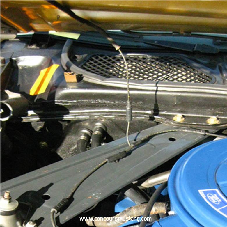

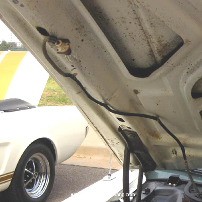

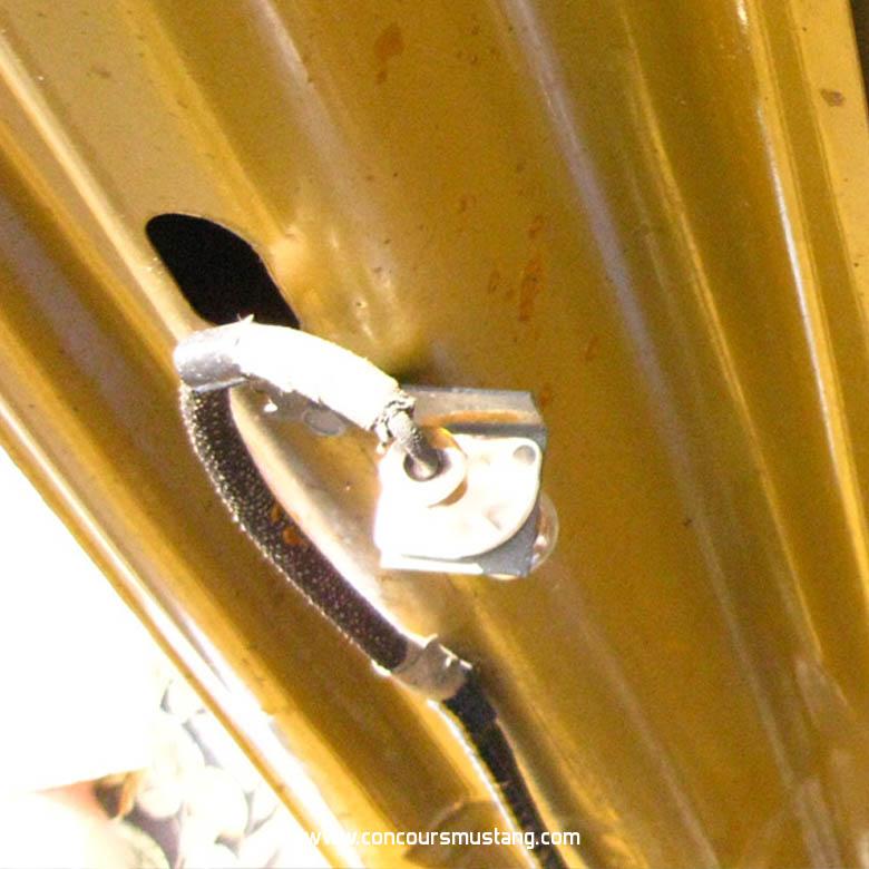

Here is what I could find in my collection
2F03H1579xx
3F03H2157xx shows some damage to the outer woven cover so its been taped up

Thank you for the photos. In looking through other example photo's on another forum I am tending to lean towards a tape covering from the first attachment clip at the back of the hood to the last attachment clip closest to the light. An alleged NOS 71 light assembly on eBay shows a taper covering over the sheathing. Several examples provided on another forum show very original appearing cars to have the tape covering in the same location. I am going to try and figure out the correct tape to use now. I do not think it is the cloth friction tape as all appear to have a slight sheen to them.

Would agree from looking at originals, the judges and with Ed that the tape was most likely not original (even though you can find the repair on otherwise original cars) but a repair as shown in the one example I posted
