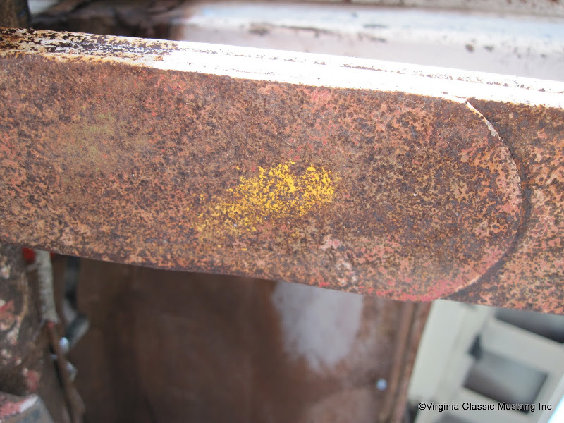

Ken,
What number car do you have?
I have a few pictures just from today from 6S033.  I am sorry that they are not better, but we have not really started the restoration.  We just finished cleaning it up a bit.  After soaking the springs in one of those rust dissolving solutions, we may be able to see more, but that has not been done yet.
Anyway, this is what I have.  At this point, it looks more like a yellow "daub" than a stripe.  Also I note that your photo shows the square hole band clamps on the springs.  The clamps on 6S033 have the round holes.
