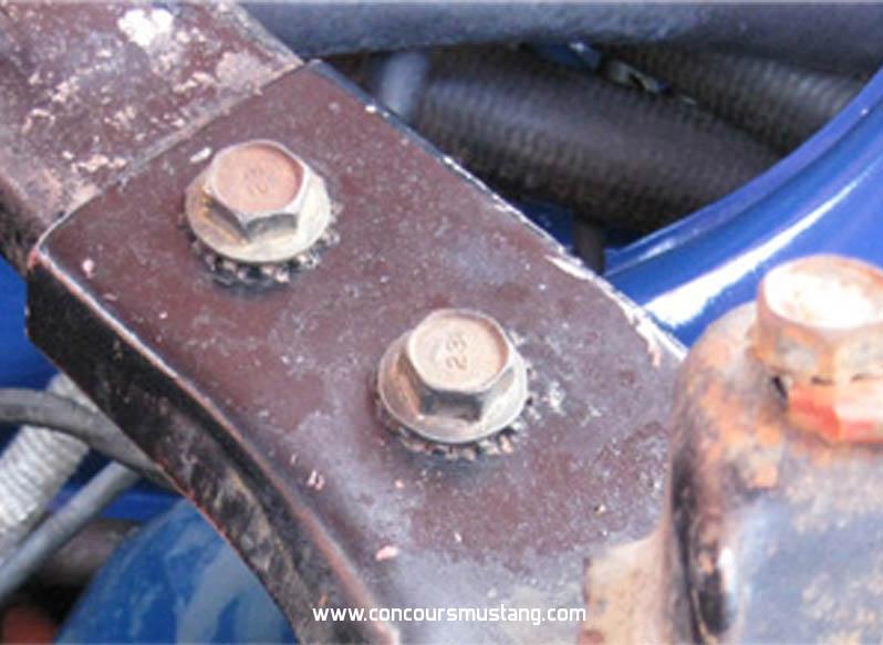

Don't know if Green Sales carries much in the way of hardware anymore.
Last option (or first for some of us) would be from a donor car. Don't know how many plants built T Birds that year and what are the original head markings but that can also be a concern when getting replacements.
The 23 with star washers (believe that is what your describing) was used on some early (65-66) Mustangs for the shock tower supports.
I believe the head style requested is a toothed (serrated) disc washer, vs. external toothed.
The ones in the picture used on the shock tower to firewall braces are 3/8-16X1.0, 377917-S2.
In my collection, I find no 5/16-18 bolts with that head marking. The majority of markings I find for that length and style are the "Sems" in a circle, and the double "ditto" (or double quote). All this "may" indicate is that bolts with that head marking were not used on Mustangs, at least made in San Jose.
