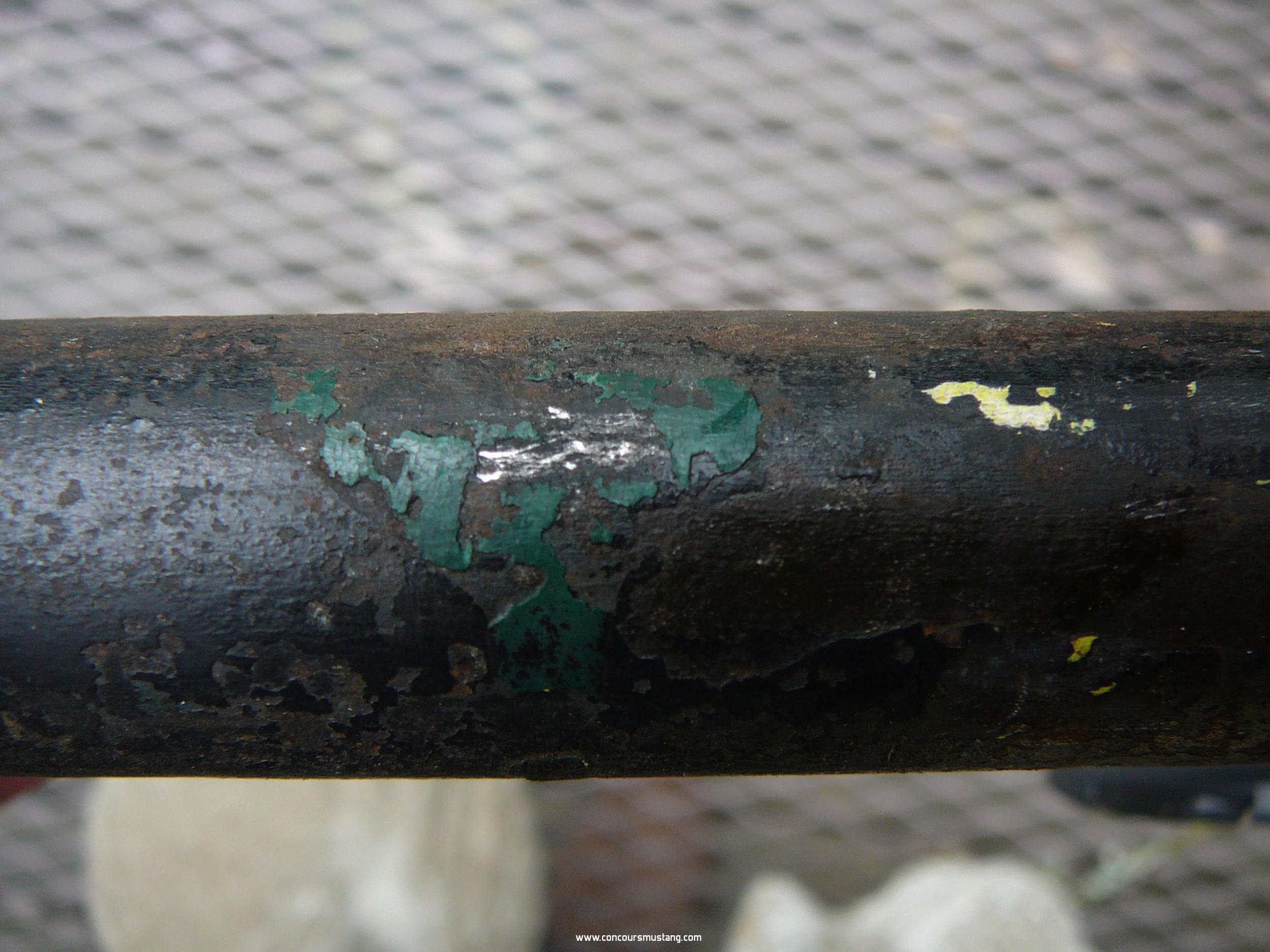

« Reply #7 on: May 16, 2018, 07:54:48 PM »
My 67 has the competition suspension -- the big sway bar.
It has sway bar color codes yellow and green.
The green is almost a dead match for Krylon Hunter Green Satin spray. I had a can on the spray can shelf(s).
But the yellow is so faint and I have so little of it I can't match it.
Where does everyone get the colors for this and the other suspension parts?

Have not found all marked this way but would suggest to stay with the green and yellow if you found it that way. The yellow that I've seen on many is a paler version of the yellow we often see and paler than the yellow examples listed in the Paint Mark Article in the Library. The marking combination was used for many years and multiple applications. The picture below is an example of the yellow. Hopefully it will come across fairly true on your monitor

Re: Sway Bar
« Reply #9 on: May 17, 2018, 12:08:45 AM »
Thanks Jeff.
Here is a pic of my bar to add to your collection. I used an actual camera with macro to zoom in on the bar in late afternoon natural light.
