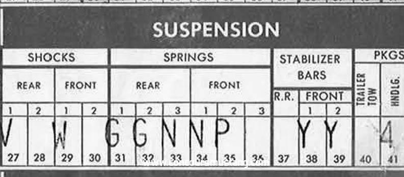

1972 Mach 1
Build Date: 01/05/1972
Engine: 351 Cleveland 2v
Trans: FMX Auto
Suspension: Competition
PS: Yes
AC: No
67 GT S-Code, San Jose, 06/67

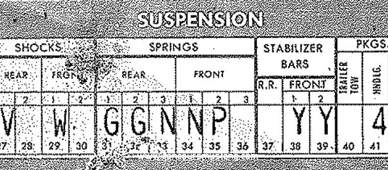

From -2F05Q152xxx
Projected build date - 06M
Body type - Sportroof/Mach I - 63R
Engine - 351 4V
Trans - 4 speed
PS - Yes
AC - No
Suspension (E41) - 4

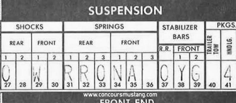

Re: 72 Build Sheet - Spring Paint Codes
« Reply #4 on: September 16, 2016, 05:20:10 PM »
From -2F05F169xxx
Projected build date - 09B
Engine - 302 2V
Trans - C4 Automatic
PS - Yes
AC -Yes
