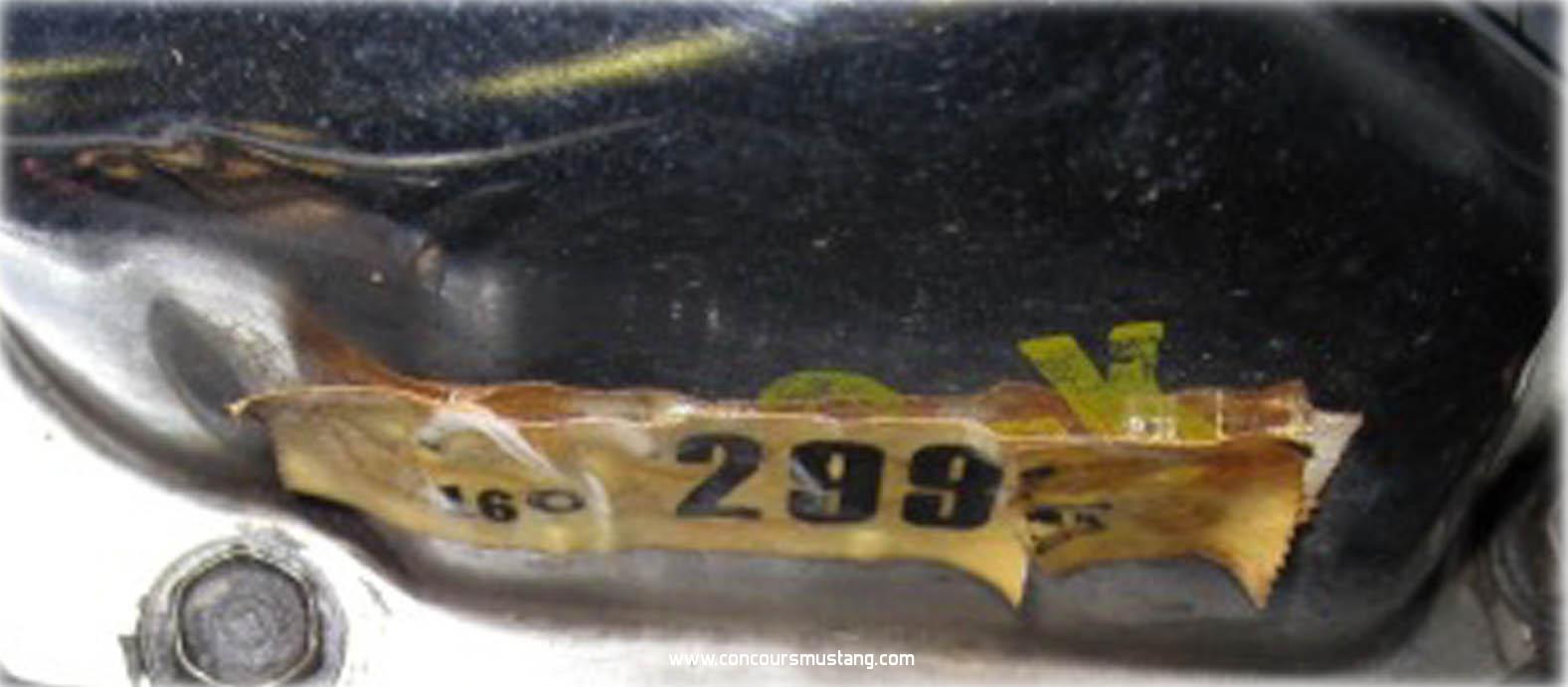

The engine pictured is a 70, but the engine decal is from a 69. Also, one of Jeff's pictures of an original 69 decal shows the timing (and something illegible above the timing) rather than a small C1.

Offline cobrajet_carl
  • Posts: 363
Re: Boss 302 Engine Detailing
« Reply #4 on: June 03, 2020, 06:46:28 PM »
Carl....not sure exactly I know what your talking about here.  One of Jeffs pictures?  What Jeff and what pictures?
Sorry, the first picture in the paper engine decal thread.
http://www.concoursmustang.com/forum/index.php?topic=7734.0
Carl
70 and 71 Dearborn mach Is

Carl the sticker you reference is a early 80's Jim Osborne creation with incorrect information. The sample he used was from a 69 Boss  429 , thus the L for Lima plant rather than C1 for Cleveland plant.
  • Posts: 363
« Reply #6 on: June 04, 2020, 12:21:29 AM »
Doesn't look like an L to me but I can't really make it out. Were Windsor engines assembled in Cleveland and just the parts cast at the Windsor plant?
http://www.concoursmustang.com/forum/gallery/1/6-050114151956-15291646.jpeg
EDIT - I guess you were referring to the decal in Marcus's guide and not the one Jeff describes as original?
« Last Edit: June 04, 2020, 12:29:03 AM by cobrajet_carl »

Offline PerkinsRestoration
  • Posts: 292
« Reply #7 on: June 04, 2020, 11:41:36 AM »
I'm not referring to the one in Marcus's article.
« Reply #8 on: June 04, 2020, 08:03:46 PM »
Carl let me offer that the picture was included in the thread about reproducing the engine ID labels and not meant to be a representation of a specific year or model original sticker. If it has I would have likely  included a caption referring it as an original for a specific application. Will try and think about that if and when I do something similar in future postings and will replace it with an original
  • Posts: 363
« Reply #9 on: June 04, 2020, 08:35:37 PM »
It sure looks aged enough to be original! Unfortunately my original (I think) decal is not of much use.
Carl
« Reply #10 on: June 04, 2020, 08:42:30 PM »
Yes I think we can all agree :) that one in your picture is too far gone for much except for location and maybe size
