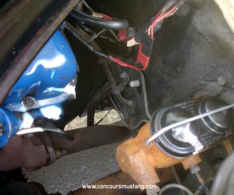

It IS INTERESTING that in this image below of what is stated in another thread as a projected build date of Mid January, that the connectors between the adapter and the harness going down to the switch, both LOOK TO BE BLUE! (could be flash and/or camera angle). ALSO...the wiring tag wrapped around the neutral switch looks to be WHITE AND there looks to be another white tag around the adapter!   DETAILS, DETAILS!!! :D

I can't say for San Jose specifically, but early 1967 Dearborn cars also had the jumper, sometimes. I have found several examples where the two leads of the neutral safety switch were plugged into the molded plug with 4 pins directly.

« Reply #11 on: December 14, 2016, 04:43:57 PM »
Thanks Scott for this info ^^^
For whatever else it is worth, some of the USED items at WCCC (Scott's "home") have the BLUE connector on them (look at the used for the C6 application)
