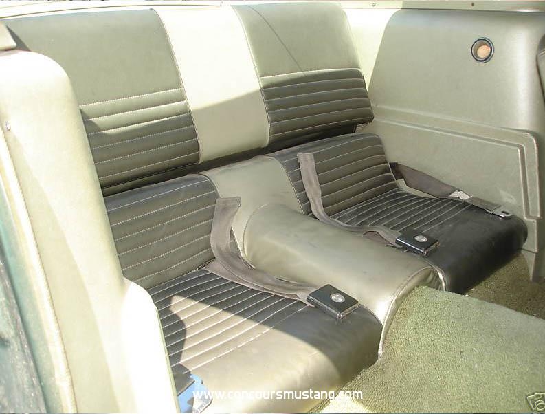

Same theme but think green.
Offline almano
  • Posts: 15
Re: 67 Fastback Ivy Gold deluxe interior parts color?
« Reply #2 on: December 27, 2016, 05:57:56 AM »
Thanks for the picture.
By any chance do You have the rest of the interior picture of the same car?
I think we lost with this two tone interior. What was what color? Light Ivy and Dark Ivy?
I found previously this picture of the back, but it looks totally different...
Thank You!

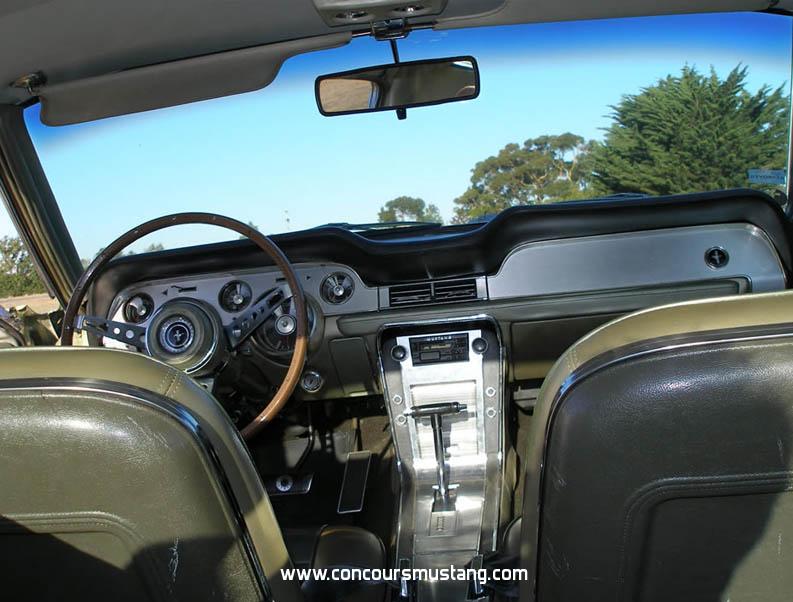

« Reply #3 on: December 27, 2016, 01:09:10 PM »
I have a single picture of a convertible with some help.
Marty's example earlier is of a 68, not a 67 but colors are essentially the same.
NOT seen in any image so far:
1.) Headliner is a pale green (not same as other interior coloring)
2.) Dash panel ~ Light Ivy Gold (includes steering column and wheel where applicable)
3.) Knee Bolster (above radio & Glove Box) ~ Light
4.) Upper & Lower Consoles ~ Light
5.) Dash Pad ~ DARK, almost black
6.) Seat Belt Retractor Covers (coupe & fastback)~ DARK
7.) Seat Belts (webbing) ~ OLIVE
8.) Seat Belt Buckles ~ DARK
9.) Kick Panels ~ Light
10.) Seat Backs (Deluxe) ~ DARK
11.) Pillar Pads ~ Light
12.) Horn Pad ~ Light
« Last Edit: December 27, 2016, 04:09:02 PM by 67gtasanjose »

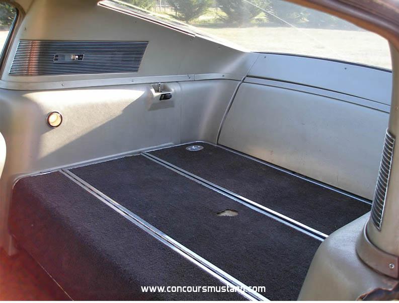

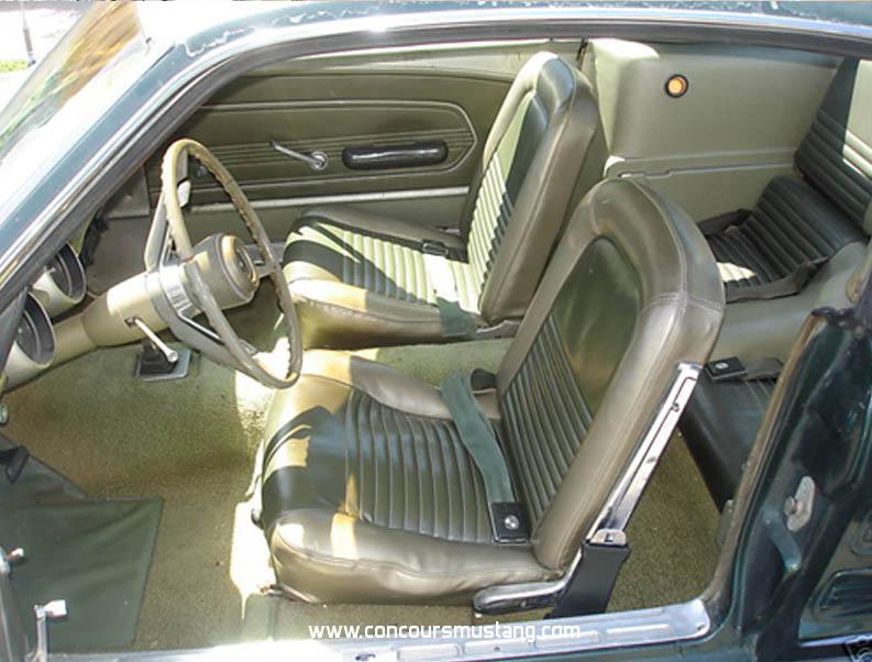

« Reply #4 on: December 27, 2016, 03:35:03 PM »
Here are some additional pictures. Standard interior (bottom three) follow the same color pattern as the deluxe so they may be of some help also
http://www.concoursmustang.com/forum/index.php?action=gallery;sa=view;id=6543
Looks like someone changed the carpet out at some point

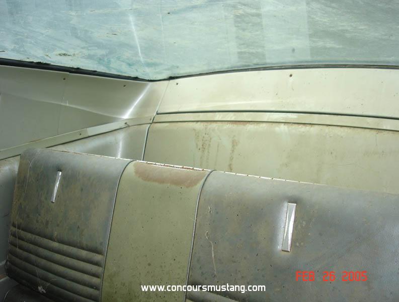

I am getting even more confused.
What determines how the rear seat insert look like? i see pictures with curved dark insert and i see with straight full insert. Also The dash insert i see silverish, wood, and black colored.
1967 Mustang Fastback GT 390 Lime Green / Ivy Gold Deluxe interior
« Reply #7 on: December 27, 2016, 06:09:57 PM »
Guess your looking at the convertible example and the 68 (its labeled that way ;) fastback example in Post #2
All the other fastback pictures posted the darker centers travel fron the bottom edge of the bottom cushion to the top edge at the top of the fold down section. Deluxe has the little silver inserts. See text below.
Didn't see a wood insert in the pictures above did see the black standard but placed the following in the text "Standard interior (bottom three) follow the same color pattern as the deluxe so they may be of some help also"
Did you see that and/or just look at the pictures posted?
For your application (deluxe) the inserts would have been brushed aluminum
« Last Edit: December 27, 2016, 06:13:55 PM by J_Speegle »
« Reply #8 on: December 27, 2016, 06:14:33 PM »
You have a 67 Fastback so the pictures Jeff provided are 100% correct for you.
The convertible picture I provided (rounded top corners on dark color) are what is found on convertibles and much the same as coupes. Fastbacks go straight up to the chromed trim. DELUXE uses the chromed button in center of the upholstery back.
... Also The dash insert i see silverish, wood, and black colored.
DELUXE interiors would be the brushed Aluminum type (silverish as you call it)
WOOD Steering wheel is optional, NOT STANDARD with the Deluxe Interior. The wood wheel has been found in standard interior cars also from the factory (not usual, but happens)
