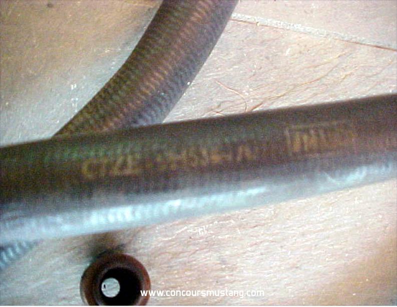

Picture of the markings on both the drivers and passenger side with the internal type, since others will surely find this thread using search in the future and both may help
Though it doesn't look like it at first glance these are two different examples

Re: Thermactor Hose - '67 289
« Reply #6 on: January 01, 2017, 04:46:36 PM »
Hi Jeff, I believe this may require further discussion to fully understand.
No problem -
I believe at this point that my short hose going from the TEE to the passenger side is original and the Ford part number has worn off.  Please see attached picture from MustangTek of the short hose.  It shows the part number (appeared to be the same number as the unrestored example you posted in this thread) and the stamped number 78FH on the same hose next to each other.  The 78FH matches exactly what is on my hose.
Have never found a red marking on an original Thermactor hose from 67 and the pattern and the red matches other service replacement hoses including Motorcraft ones also. Must admit that Mustang Tek doesn't always post the most correct pictures but often best they have available. Its a big job and lots of details to keep an eye open for
The other thing that is confussing is you posted a picture of the drive side hose that isn't what I expected either.
Interesting since only posted that one of the markings in the other picture of the passenger side I only showed approx a third of the diameter and for only about 2 inches of the hose.   Of course never posted pictures of those hoses since I was focusing on just the passenger and its not unusual for one hose to be correct and the other not. Never said those hoses were both correct/original and the reason the pictures were cropped pretty close ;)
The hose that runs to the drive side from the Tee, by my research was a smooth hose that had 4 grooves in it.
Have seen 3-6 ribs which identify the supplier. Don't agree all had the same number of ribs no more than the radiator hoses all having the same number as well as a dozen of other examples through 1973 applications. Examples of Thermactor hose ribs below.

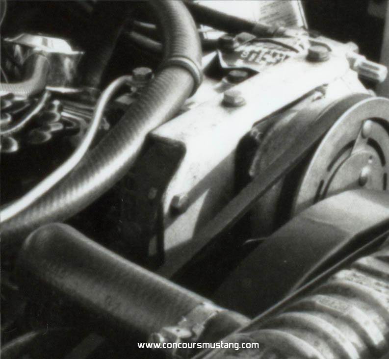

Picture of a drivers side taken in 67. Not sure why its already been modified  (AC bracket and in turn the hose retainer clamp and hardware)
See attached picture from a unrestored car that was posted prior showing this detail.  It is consistent with what I have found on other unrestored cars from that plant and time.  The picture you posted is of what I believe is the hose running from the gulp valve to the Tee.  It's hard to read the number from the pictures, but the texture of the hose is more costistent with the other hoses and not the one going from the Tee to the drive side check valve.
Yellow printing on that one is interesting and may indicate what the date was printed on that one and we don't see that on any of the others.

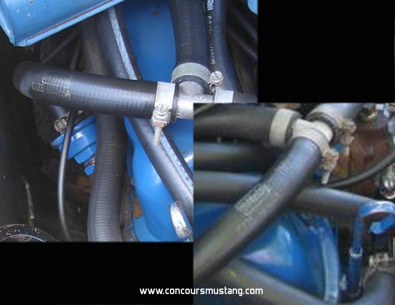

Took these photos today under the hood of my SJ Dec '66 C-code.
The first pic below is the driver side Thermactor hose with three ribs; there are no other visible markings.  Based on today's discussion, this may be an original hose.  (The reason I started this post is because I thought this hose needed replacing with an original hose).
The second pic below is a close-up of the passenger side Thermactor hose with a 78FH marking; although not the best stamping.  There are no other visible markings.  I believe this hose has always been on this car.

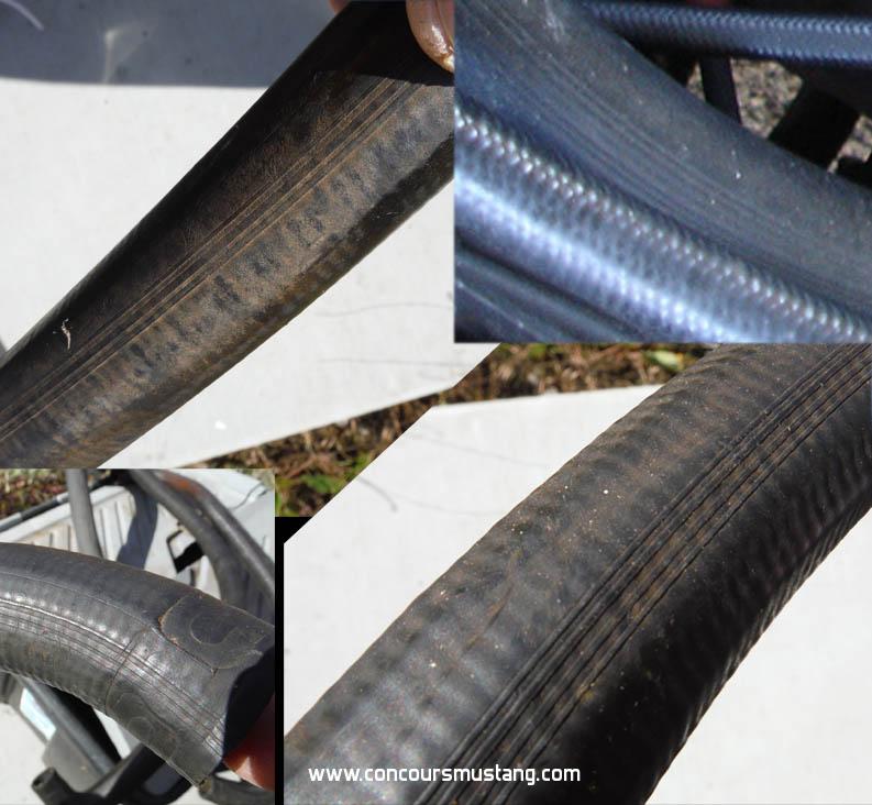

Do not know if it still mathers, but here are some close up pictures of the hoses that are in my possession.
I am not sure (at all!) that those hoses are the originals, but they came with the car in a box when I bought it, assuring that they came off that car  ::)
But it is a fact that the hose that goes to the driver side intake is much 'smoother' than the one that goes to the passenger side intake.
There is also a 'Fomoco' stamp on the hose to the driver side.
So, I let the experts decide if they are relevant or not.

Resurrecting this thread after several months.  Thanks for the detailed photos.  I'm going to be removing the Thermactor hoses to do some cleaning and I'll look for a FoMoCo stamp on the driver side hose.  Curious where the FoMoCo stamp was located on your driver side hose; e.g., front, middle or rear section.

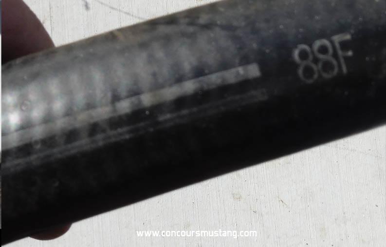

Here is a picture of another hose I picked up from an unrestored 67.  Stamp is on the outside edge per picture and has the 78FH stamped on it on the reverse side too.

Nice pic and clear stampings, especially for a 50 year-old Thermactor hose.  Thanks for posting. Hoses on my 67 are well-used and most of the stampings are faded away.  Not complaining though, at least the hoses weren't removed over the years and are still functional. Nice Wittek clamps too, replated?
