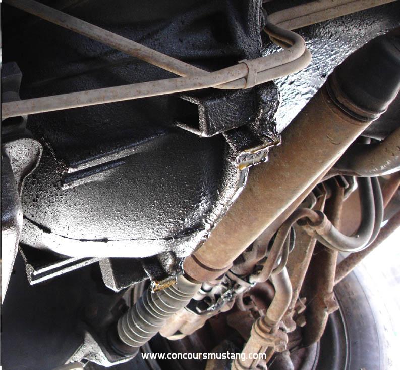

Hello, I am after the CORRECT finish for my 66 SJ GT Power Assist Hydraulic ram...... is it just raw metal or was it a painted finish.

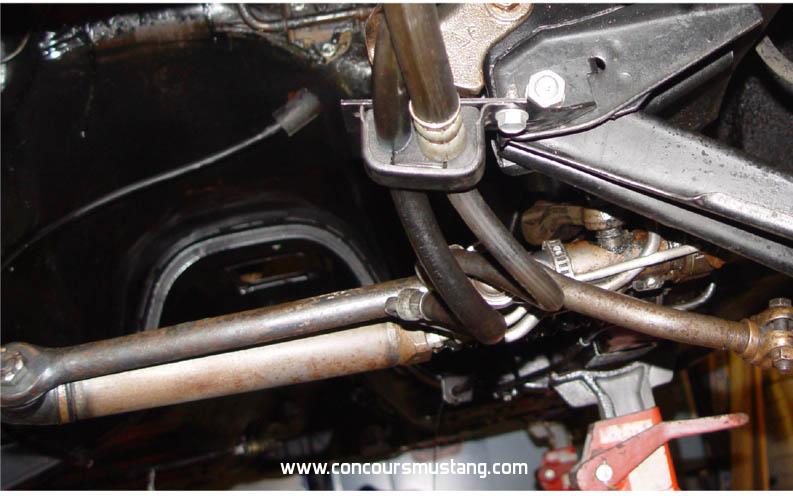

Kind regards,
Richard.
Bare like in other years for the ram part of the PS assembly. Early original example below. Believe I included how to finish (at least how I've done it successfully) is shown in a number of threads but basically strip it , get the metals back to looking new, soften them with gun blueing (I redo the dark heat bands over the welds and tube metal near by)  then work them back with steel wool, then oil/protect
This thread shows on in the box as part of a kit
http://www.concoursmustang.com/forum/index.php?topic=5699.msg32653#msg32653
Related threads that may help your efforts in refinishing
http://www.concoursmustang.com/forum/index.php?topic=13.0
