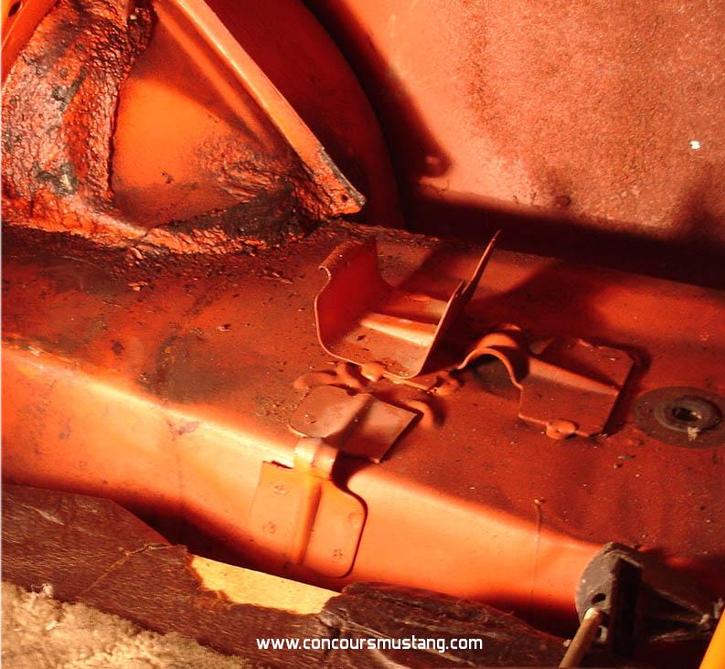

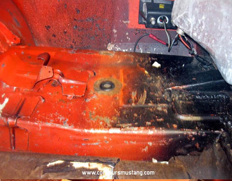

Sounds like your car had a regular spare. If not the passenger side trunk floor would have two spare tire hold down brackets and a holder for the inflater bottle/cylinder
Some pictures of 70 mounts and brackets. Forgive the owners - some are slightly bent and at least one had some black rattle can paint sitting around    ::)

I think that settles it, my Marti report does not mention one, I only have the one J-hook bracket welded over the edge and I have no desire to make it anything other than what it was at the factory.  I guess I am going to get rid of my space saver and start looking for a full size.  Damn reality;I was hoping it came with one!  Damn Damn Damn!!!  I appreciate everyone's patience and spot on knowledge, I can see I am going to wear this site out as I go through this car and learn from you all.
