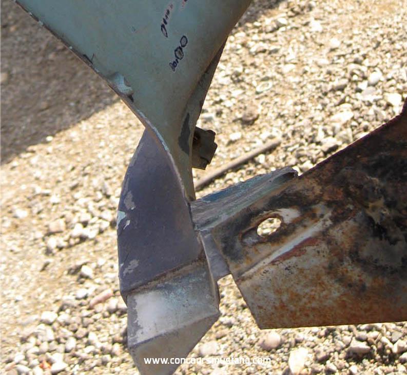

Stud mounted/attached to the stone guard passes through the headlight bucket and through bracket to radiator support and is held in place with a nut from below.
Oval hole in the bracket - looks like a round hole in the headlight bracket
Though I believe they are out of order this picture may help

I am a bit confused, pic shows the bucket bracket under the support bracket, text says it should be above. I have both versions left and right, but one bucket was exchanged in 1984.
The 67 Oswald Assembly Manual Shows it should be on top of the support, but not clearly, the 68 is even more fuzzy. Searched the Web, but I see both, the bucket bracket under the support and above. Assembly mistakes possible ex works?
What is more correct? Pic or text above?

3rd pic is the bucket bracket under the support on my car. If it needs to go between Support and Stone guard, I would like to correct it now before breaking it.

The ends of the stone guard have to fit ON TOP of the headlight buckets. That's because of the screw and retainer assembly. You can see the "recess" in the buckets for the ends.

Just to feedback. Found both supports above the headlight bucket in the end, also checking my earlier pics before disassembly. Not a reference, since the car had been apart twice.
But I asked a few 68 mates and some have it on top or underneath. I assume the one pic above labelled with concours was an unrestored car.....
The picture in reply #1 is a picture of a car in a wrecking yard so guess it's was unrestored but not unmolested. The concours is part of the site watermark applied to all pictures stored and then posted on this site
