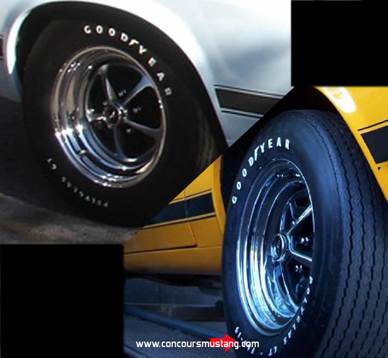

According to MCA
F60x15 no-size Goodyear before Dec 1, 1969 built cars
Post Dec 1 built cars with size in raised white letters
No-size or No-side?
No-size doesn't make sense with F60x15 sizing.

Concours or judging speak. Compares the highly visible raised white letters with or without size included
Added to my earlier post showing the change over date since OP didn't provide when their car was built :(

Jeff S. I have documented nov 69 built cars ford & mopar having the F-60-15 SIZE tires from factory & 1 low mile 1970 b9 built late oct 69 having F-60-15 tires with the size in white letters somay have to depend on how tire inventory was shipped & stored & if a new shipment went straight to the Dearborn assembly plant as after talking to John S.who worked at akron oh goodyear plant he say tires were shipped 50 to a pallet by train to Dearborn plant.

So are we changing the understand of what is the correct original tires for the general production period or are these exceptions to the "rule" ?
Just asking about Fords built at the three plants - not other places or Mopars  ::)

where did the dec 1 changeover come from?

Good question and I should have posted where that info came from since it's not my research. Added where if came from in the post
MCA

According to Goodyear prints from John Kelsey the tire size in RWL was a  was a late November 69 production change. I would like to see an original tire with size in RWL prior to Nov. 1969?  The date code on the tire is the truth teller.
