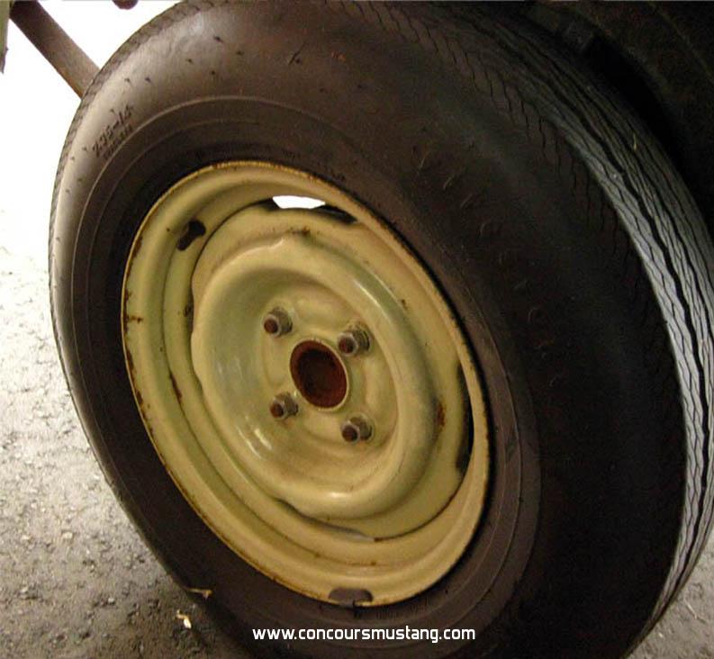

Now that you posted some pictures let me see if I can help
1- First the four nub center would be correct for your 69. The change from three to four came between the 67 and 68 production years.
2- The red paint mark was the factory marking in 69 for a 14 x 6 steel rim. This was the same design as used in 68
Front and back of a 68 rim for your comparison
And the face of a 69 steel rim for comparison also
Both wheels are painted body color because the cars were originally ordered with the poverty/dog dish hubcaps
