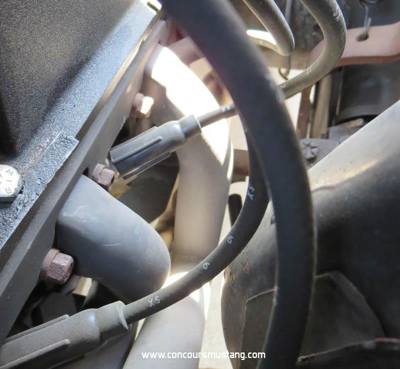

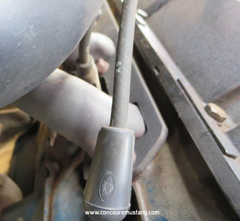

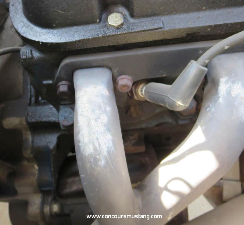

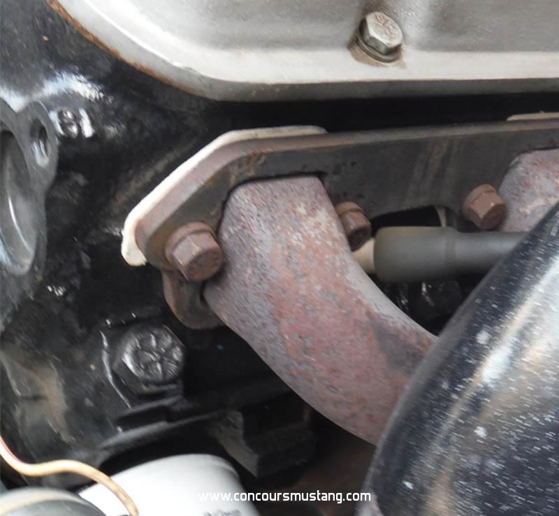

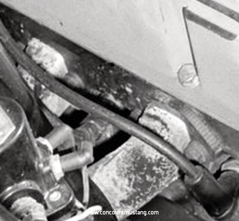

Know this is an older thread but figured I would add a series of pictures I posted elsewhere to this one rather than starting another in an effort to keep things neater and reduce the number of hits on the old search feature if you use it. Especially since they are connected to one another
Here are a few to assist with the discussion. Labeled each so discussing/referencing a particular one is easier ;)
Header #1
Header #2
Header #3
Header #4
Header #5
