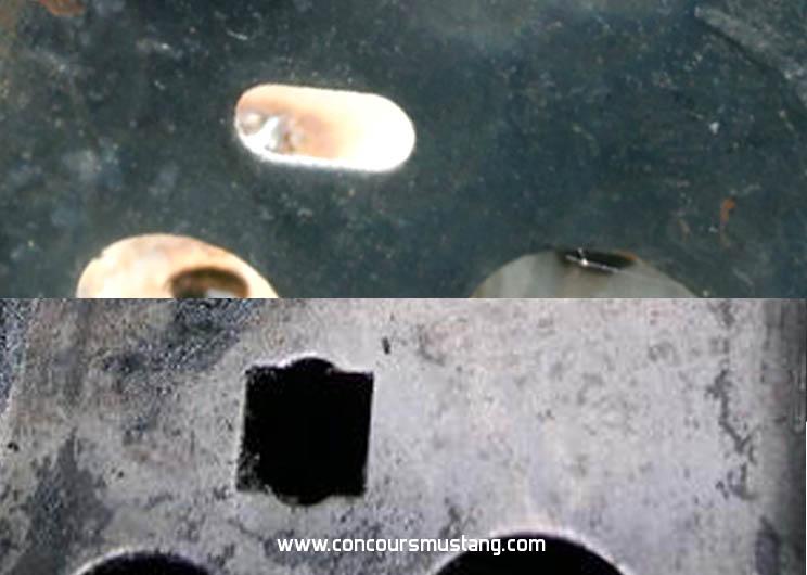

Picture of the other two versions of the hole in the radiator support being discussed. These are not to scale

Sorry to be the "fly in the ointment", but I do question or doubt that it was "standard practice" that the oval holes were modified, That is not to say that some oval hole "left over" inventory may not have been (although if there were left over oval plugs, why would the holes have been modified ?). The reason I say this is because of several things. In the pictures that Bob G just Posted, as well as the one that John posted with the duct tape "background" in his summary, note the axis of the supposedly remaining portion of the oval holes; it is vertical (this is also what is shown in the Illustration in the Body Assembly Manual, page N7-8105-1, for the square holes). The oval holes in the radiator support had a horizontal major axis. And finally, the rubber plug (Part # 376966-S) shown in Bob G's most recent Post is not an oval plug, but a 5/8" diameter round button plug according to the Ford Standard and Utility Parts Catalog.
I truly feel that the square hole was a totally new stamping. The square part of it used for the Cougar headlight applications, and the two rounded (segments of a circle) portions in order to facilitate the use of a round, button plug. The oval plug (Part # 377841-S) is totally different than the button plug.
Based on the Body Assembly Manual revisions, along with all of the pictures that have been furnished, I think we are dealing once again with another Production Change. Oval holes with oval plugs early in the year, and square holes with button plugs from about mid-year on.

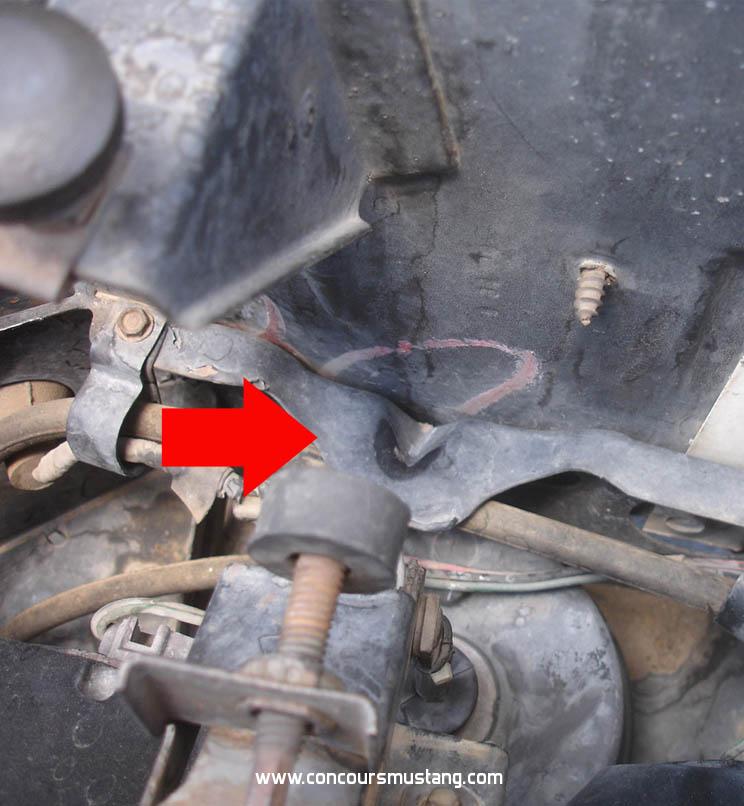

Purpose for the holes (one each side)
To hang the headlight assy from the radiator support

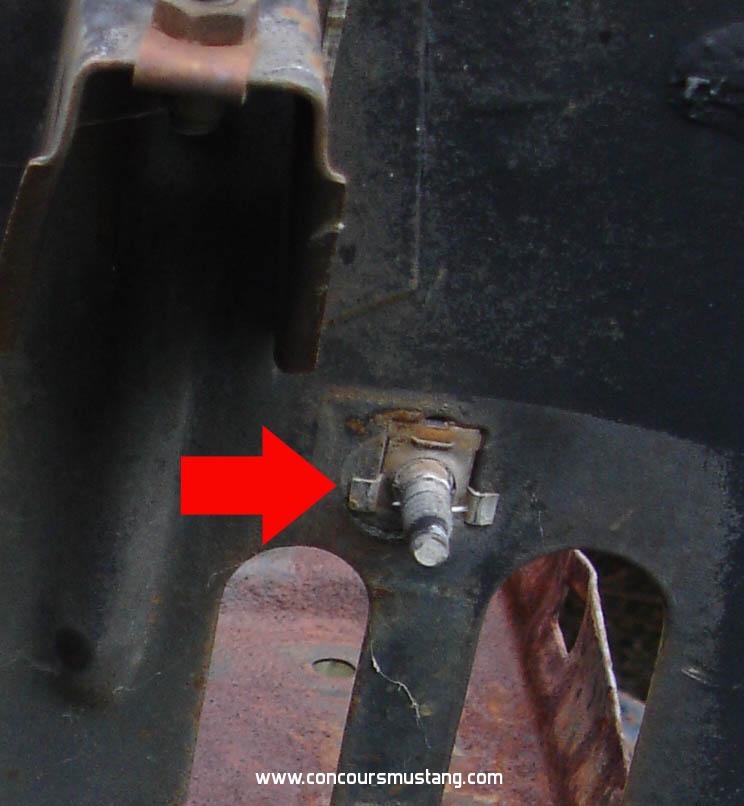

And the stud used for the square (with horizontal bumps) hole. Looks to me like its slipped down in the hole or been struck/unseated

When I say modified it is most likely that the die that stamped the hole was modified and not a existing stamped oval hole that was later modified to a square shape. The shape was stamped at one time. This squared shape is typical in later 67 . I have two 1968 Metuchen Shelby Mustangs ,one early Dec 67 build and  the other a June built 68 that have the EXACT same shaped hole which would nullify your  "left over inventory" theory . Finally you need to get your reading glasses or magnifying glass out because the center of the plug in the picture is OVAL and not round. I am not sure about 68 plugs being oval or round but I have a high confidence level for the oval plugs being used in 1967 regardless of oval or squared hole based on my experience and observations. I suppose that there is something to be said for the credibility of getting out in the real world to find evidence on the cars vs. apparently arm chair speculation based on what you find in books. If you haven't seen these squared holes with the oval edges in radiator supports what with that shape being so prevalent in 67 and 68 then the most obvious conclusion is that you must not be getting out much.
It also looks like it's installed backwards.

The early oval hole, used a different stud for mounting the headlight bucket on a Cougar. Stove bolt type with a round flat nut or keeper holding it to the panel.
I would be inclined to believe this is a prime example of an owner induced modification, function unknown.
