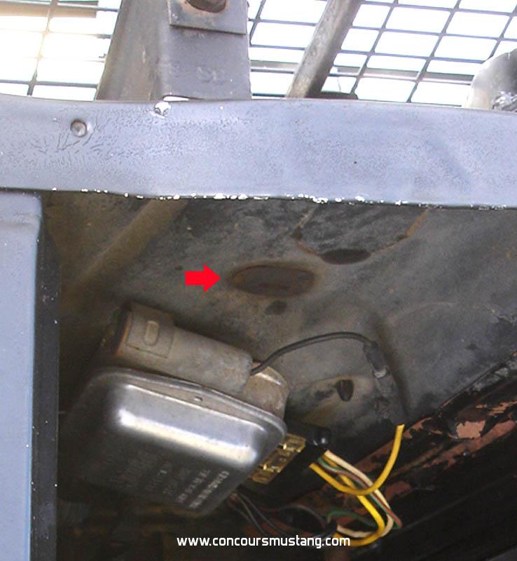

That being said, about the only thing I can add is that on my '67, the lower radiator support oval holes (which are the same size as the uppers) do not have, nor is there any evidence that they ever did, any plugs.

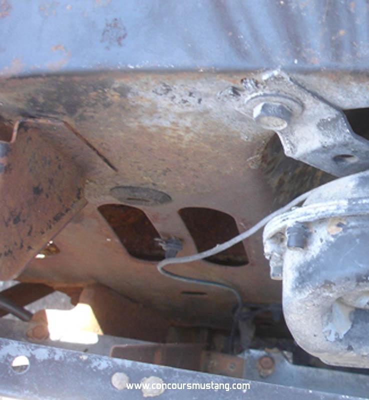

I looked at a June built radiator support today (SJ) and it's square hole had the same plug installed from the engine side as other pictures posted.

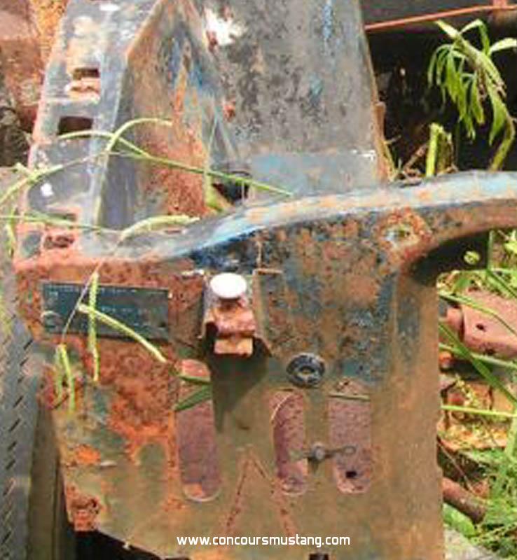

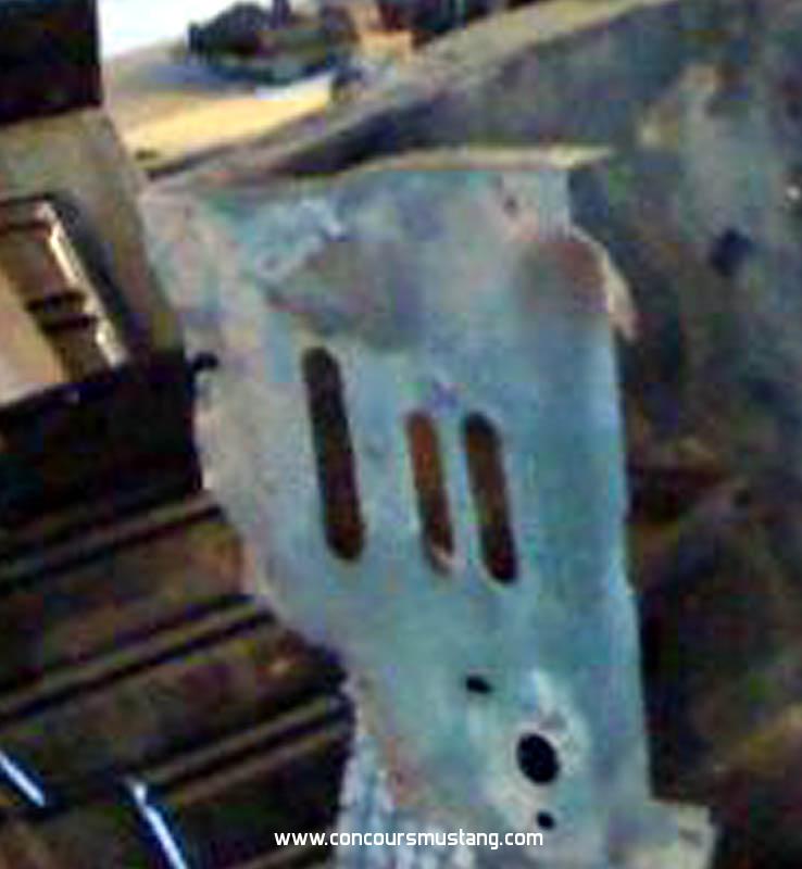

Is there any consensus on where/when the oval shaped plug versus the round plug was used? In my non-scientific research at a couple of junkyards it seems that maybe the oval plug was a 67 item and the round plug was used in 68 but I'm only speculating.

Like most things 1967 and really best practice we need to look at unrestored cars to make a determination of an approximate change over.  That needs to be done at all three assembly plants. If you look at my attached report from an earlier post you will see that I found both oval and square instances for 1967 model year cars from all three plants.  The VIN numbers help start to hone in on the changes but we would need more data to reach a consensus.   Jeff provided a few more data points as well.  I'm not taking it further myself but if you are wondering about a specific car provide a partial VIN and I'm sure you will get to the answer.    It is safe to say though that the change was not commensurate with the new model year.
