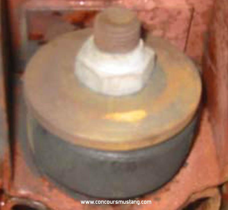

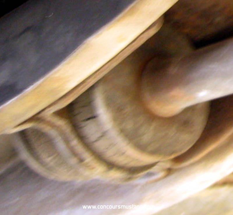

1st pic is my June 65 convertible. 2ed is my Aug 64 coupe.
Offline Scott302
  • Posts: 165
Re: Strut Rod Washers
« Reply #2 on: June 20, 2017, 03:31:15 PM »
1079 from Mike's Aug 64 coupe matches the Ford blueprint I have for the C2OA-3A142-D washer used on 62-65 Fairlane.
0632 from Mike's June 65 convt matches the Ford blueprint I have for the C5DA-3A141/2-A washer used on 64-65 Falcon and 65-66 Mustang.
Applications listed according to the June 68 MPC.
I have seen the C2OA on other early 64 Mustang's.

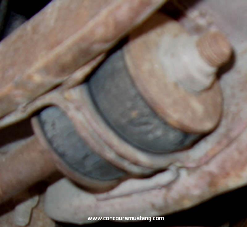

The 3rd image is from the NPD 65 Mustang with 1700 miles.  5T07T147XXX, scheduled build April 65.
Close examination appears to show very slight contour similar to the C5DZ washer but doesn't match it exactly.

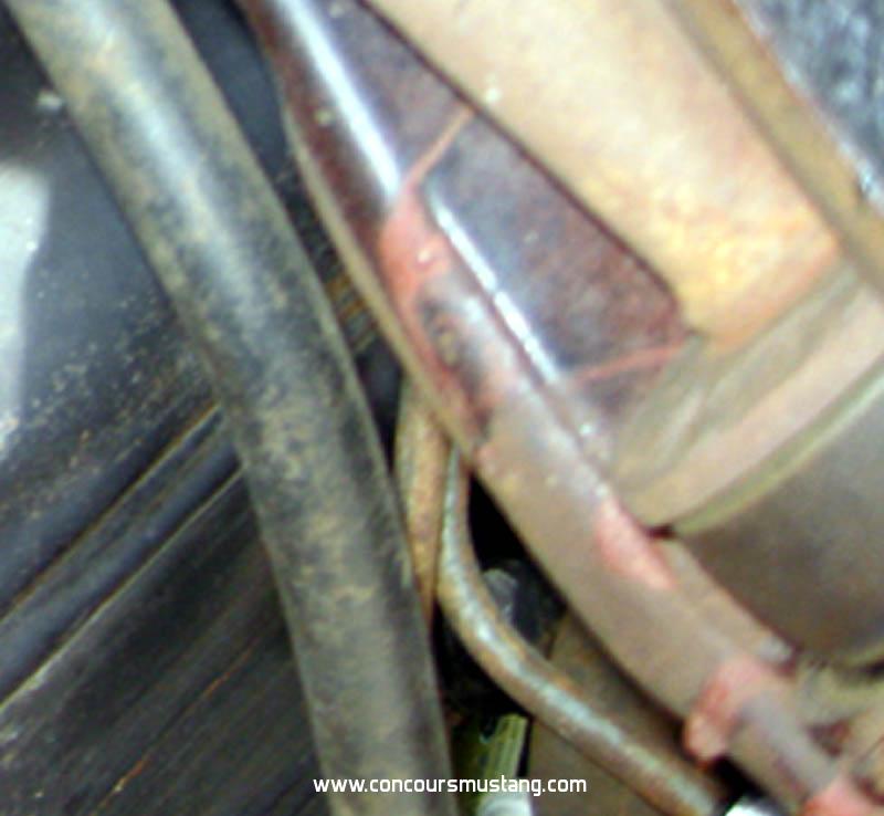

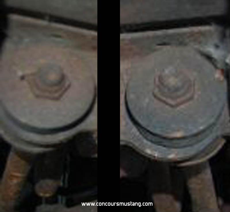

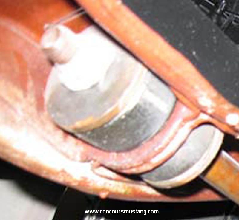

I took a look at the subject by going through my pictures and can only offer the following after going through cars built at San Jose in the 170000-182000 or so range.
5R17090x
5R17621x
5R18005x
5R18178x
And one from a VIN unknown example
Sorry for the low resolution and dirty parts
Did find what appears to be a similar washer on a 65 NJ built car 5T15463x
