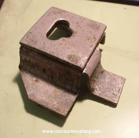

« Reply #7 on: July 24, 2017, 10:27:02 PM »
Jeff,
I apologize.  The picture you show of the parking cable bracket is actually from my car.  I submitted it in another post and didn't realize I inserted the wrong picture.  The colors on it are not correct.  I had my camera on the wrong setting.  The bracket is laying on a green drafting table.  As you can see the table is not green.
Attached here is the picture representing the real color of that same bracket.  The camera settings are correct for this one as you can see the drafting table is green.  This bracket fell off the floor pan before I had the car stripped.  I wire brushed the rust off of it.  As you can see, it better resembles the gray of the other pictures of the car.
Sorry for the bad picture.
Barry

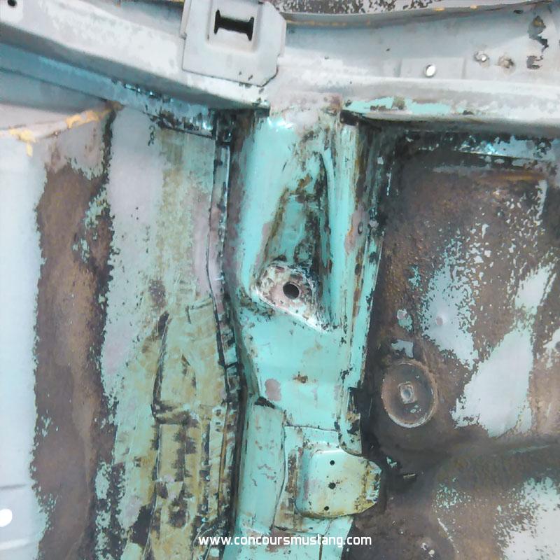

Re: Non-Red Oxide Undercarriage Discussion - Sept/Oct 69 NJ
« Reply #8 on: July 25, 2017, 12:02:34 AM »
Guess this is a great example of why one can not trust what we see posted on the internet when it comes to colors, tones and tints.

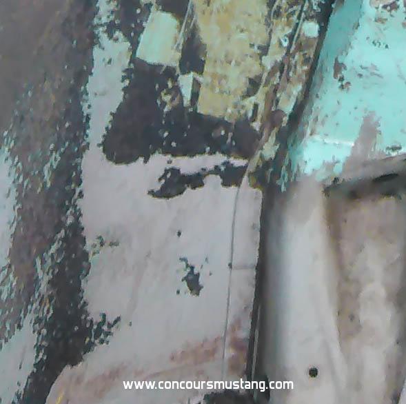

You have likely seen  the picture of the aqua car before so let us discuss that one. Unfortunately we only have a single picture and one of low resolution Probelm I/m having is from just the one angle its difficult to see if the light gray is over or under other colors.
For discussion purposes I labeled finishes, coatings and such
Dark green - The light gray
Red - Sound deadener or undercoating
Purple - Bare steel/sheet metal?
Orange - Exterior color overspray. Allot of this car.
Blue - Is this signs of repair and brazing?
Light green - Is this chipping of the top coat exposing what is under - through the light gray applied to the frame rail and area.
As you can make out the wheel wells on this example also have gray pretty heavy in the wheel wells
You can make out the areas where someone has been scrapping with a pulley knife or similar plastic blade. Likely removing the undercoating and exposing the body color under in the area just behind the shock mount support
Keep getting the feeling I'm missing something, a sign or a point, in the picture that would provide a clue to what took place
On your car we had a couple of areas where it seemed it was much darker than other areas.
« Last Edit: July 25, 2017, 12:11:05 AM by J_Speegle »
« Reply #9 on: July 27, 2017, 12:19:04 AM »
Wow, there is a lot going on here.
So, I assume the order of application on this car was:
1) Gray primer on undercarriage
2) Gray primer in wheel wells
3) Sound deadener on undercarriage after axle and brake hardware but before driveshaft and exhaust
4) Sound deadener in wheel well after installation of suspension and axle
5) Body color with overspray on undercarriage
6) Engine compartment black (not discussed here)
I need to apply the sound deadener on the undercarriage since my car is a Mach 1?
« Reply #10 on: July 27, 2017, 04:44:15 AM »
Uh ... no can't agree with much of that based on how the cars were typically assembled and its not like they could pick up sections of the line and move them around the factory to apply just to your car or even a group of cars IMHO IF we need to follow this line of discussion I think we'll likely break it away into a new thread
1) Gray primer on undercarriage- Will leave that alone since that is the basis of the original question
2) Gray primer in wheel wells - As mentioned a different gray, a gray primer surfacer was typically applied to the exterior body to fill the small voids and imperfections left in the red oxide application
3) Sound deadener on undercarriage after axle and brake hardware but before driveshaft and exhaust - No the sound deadener applied to the floor was most likely applied at the same station or one before or after (given the needs being different for spraying verses installation of components) when the front wheel well sound deadener was applied
But yes the sound deadener (if you have a Mustang model that was done that way) was typically done before exhaust and maybe driveline. Still working out that last detail as it may have been wrapped, shield or other wise protected from any application. Subject for another thread
4) Sound deadener in wheel well after installation of suspension and axle - The suspension and axles (and just a ton of stuff) was installed in the second part of the assembly and the rear wheel wells sound deadener was applied in the first part of assembly before body color was applied
5) Body color with overspray on undercarriage - in the trunk in the rear wheel wells and so on
6) Engine compartment black (not discussed here) - After body paint application
Though it's for 70 Dearborn you might want to take a peek at the article in the Library here related to undercarriage painting. Might answer a number of question in general
As mentioned above - yes Mach I's, Grandes and some other models had an application of sound deadener applied to the floor pans,frame and things attached at the time
Now back to the discussion of the gray floor possibility ;)
