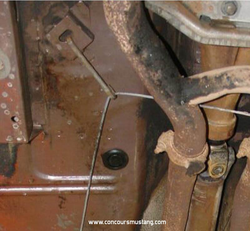

Re: Batch/Slop vs undercarriage color - 69 Dearborn
« Reply #9 on: August 07, 2017, 08:44:28 PM »
Red oxide definitely out of the ordinary for that time period. Hopefully Jeff has some examples cataloged for that time period to corroborate what you are seeing.
Sorry looked at my files and notes and can't place another (than your report) in that time period.  Doesn't sound like you took pictures to document what you found unfortunately
Now at the same time I do have an owner that reported red oxide was
As Bob mentioned there is possibly a chance that what you saw was a batch color that for some reason was more reddish and that was what was used
Here is an example of such a finish Unfortunately the poster did not provide anymore information that the year, model and plant :()
For comparison here is a red oxide 69 Dearborn example
« Last Edit: January 21, 2020, 06:33:31 PM by J_Speegle »

Jeff,
Thanks for the posting with the redish-grayish and red-oxide undercarriage color photos. My car was definitely closer to the red-oxide primer color, as in area of undercoating flaked off you can see fresher color of red-oxide primer. Over the years the red-oxide faded i assume.
Again thanks,
Nils
