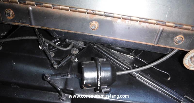

This came up on another forum the other day so I figured I should share and post here for the benefit of members and others watching now and in the future
Question was - Was the glove box hinge attached to the glove box door or the main dash when painted interior color for a 67 San Jose built Mustang/Shelby?
What we have found is that the glove box was installed/attached to the main dash when it was painted so the glove box, hinge, mounting hardware all got painted with the main dash. There are some periods (don't know why or have found a pattern yet) where one of the hinge to main dash bolts were not painted. Doesn't make allot of sense but just reporting what I'm finding. From looking at a number of 68's the pattern/practice appears to be the same as far as the glove box doors being installed when painted
Just one of many pictures illustrating this finding. In this case the painter didn't put out much effort to reach under the dash and cover all the exposed surfaces. This produced shadows on the example and the expected bare sections of the piano hinge used to attach the glove box door.  And yes some prior owner rattle canned with black spray paint the front/visible section of the heater :(

Jeff-woukd this be consistent with other factories or is this a San Jose only process?
Re: Dash/Glove Box Paint Process - 67 San Jose
« Reply #2 on: August 18, 2017, 05:18:42 AM »
I believe its possible that it applies to the other plants  but we'll see  as I'm looking at other plants and expanding out to 68 also in my stuff. Going to be difficult as not allot of people take pictures of the bottom of their dashes in that area for any purposes so examples will be few I would expect. Its also likely other members may have unrestored cars they have access to that can offer data points also.  Might take a while but at least we got the facts and the idea started

Thanks for showing what you found on your car. Not sure if its the condition or your particular car but can't recall every finding dash paint that I would call close to yours in the ability to reflect the light unless it was rubbed or cleaned allot
As for your findings - (to be clear) you only found one lower hinge mounting bolt painted?   Since we have all or some there seems to be a difference in findings. Not sure if this is a difference between shift (guy assigned that task on each shift) or time period related.
What I find that might be a problem with the loose hinge theory is that the glove box door had to be painted inside then closed and remain in an up right position while it was painted again. With a loose hinge at the dash one would expect to find scratches from movement or uncovered bare steel )at hinge to dash or around the mounting bolts) on original cars as the worker adjusted the glove box door in the opening after the paint dried
