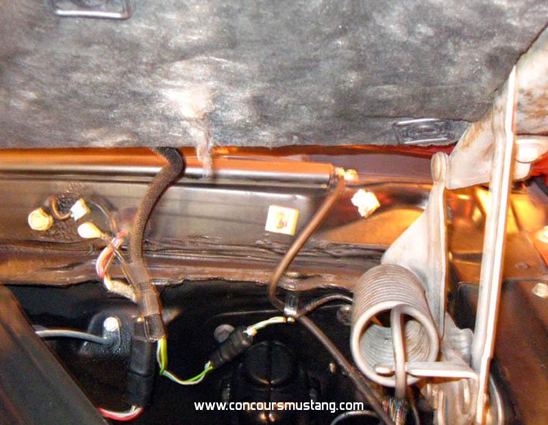

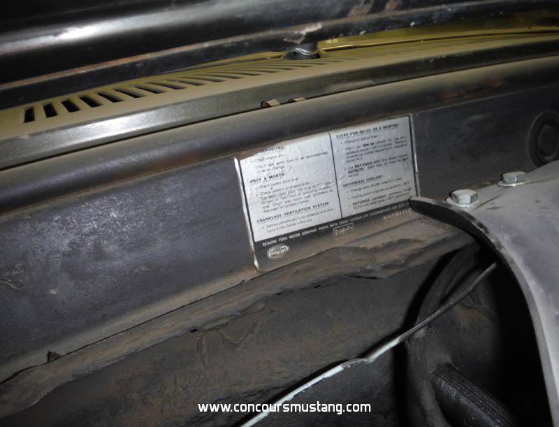

Closest I have records and pictures of is from one with a projected build date of 15E (May 16th) Sorry don't have the Marti report for it for a real build date but (KK number about 30 cars after your range) it appears it was built after the range you identified
It was originally engine compartment black above the firewall to cowl pinch weld seam. Would say that the change from body color to blacked out changed when they changed the non- Boss 429 Dearborn built cars.  Earlier in the spring/late winter as discussed in other threads
Sorry this is a low contrast comparison but you can make out that the cowl section is painted black not the shinny or smooth finish of the dusty exterior

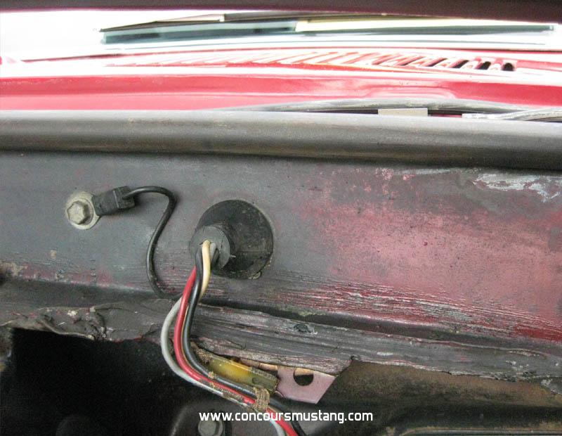

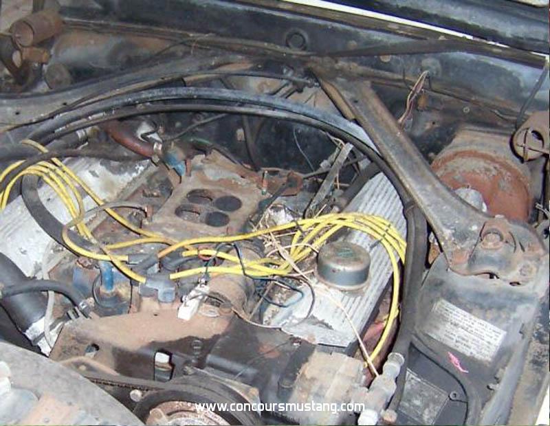

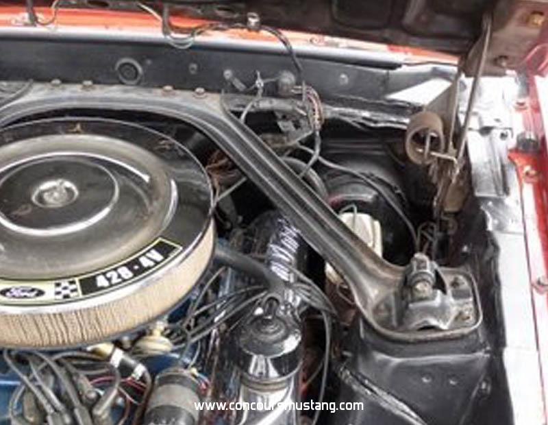

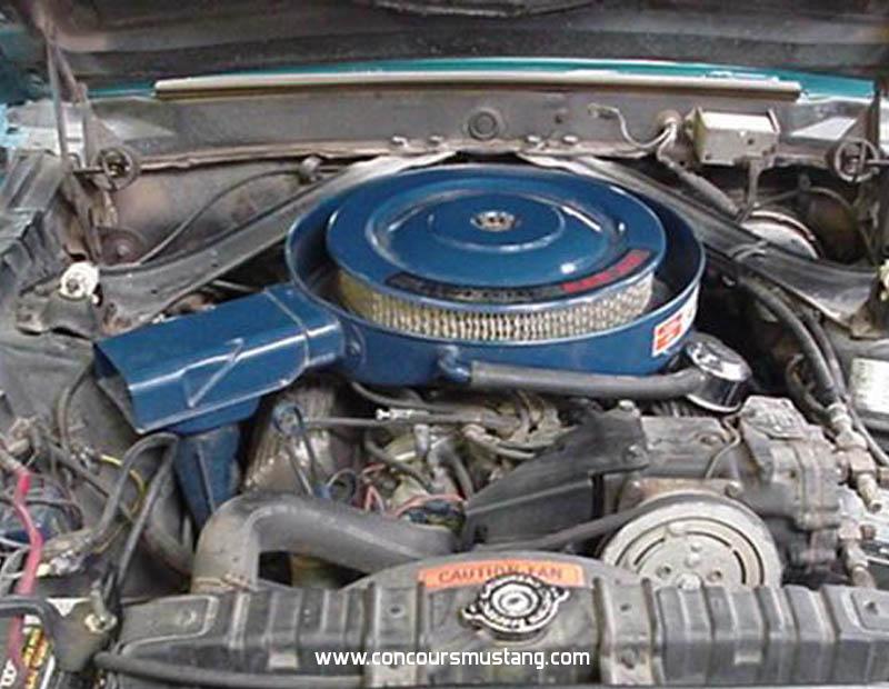

Besides the one above yes plenty.
Here are a few more - All unrestored second half 69 Dearborn cars. On red cars it seems that the black was applied thin or the black just wears off/doesn't age as well as other colors

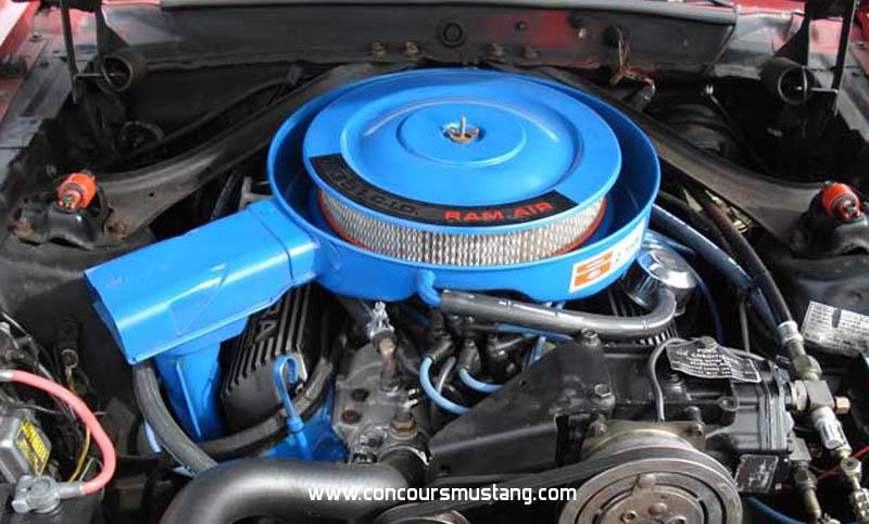

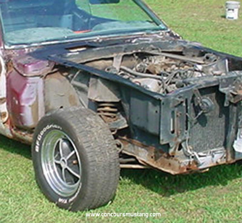

I had owned KK1785 and the firewall up to the cowl was black and the car was assembled at Dearborn May 8, 1969, 8 days ahead of scheduled build for the 16th.
Image from when purchased the car.
