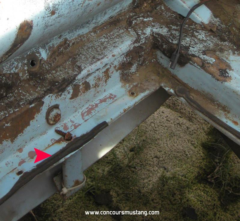

Almost black grey or just black is what was used at the gas tank, under front fenders and elsewhere originally. Material can become whitish and chalky when exposed over the years to the elements. There is at least one prior thread with a discussion on the stuff here on the site
Most just use the 3M black strip chalking. Take two or three stripes work them together without stretching the length then roll them together into one strip. connect multiple ones together around the opening and set the gas tank in place. Tightening the tank down with spread the chalking and create the needed seal your looking for
Same material but a few examples from some other years (67 and 69 in these two)
