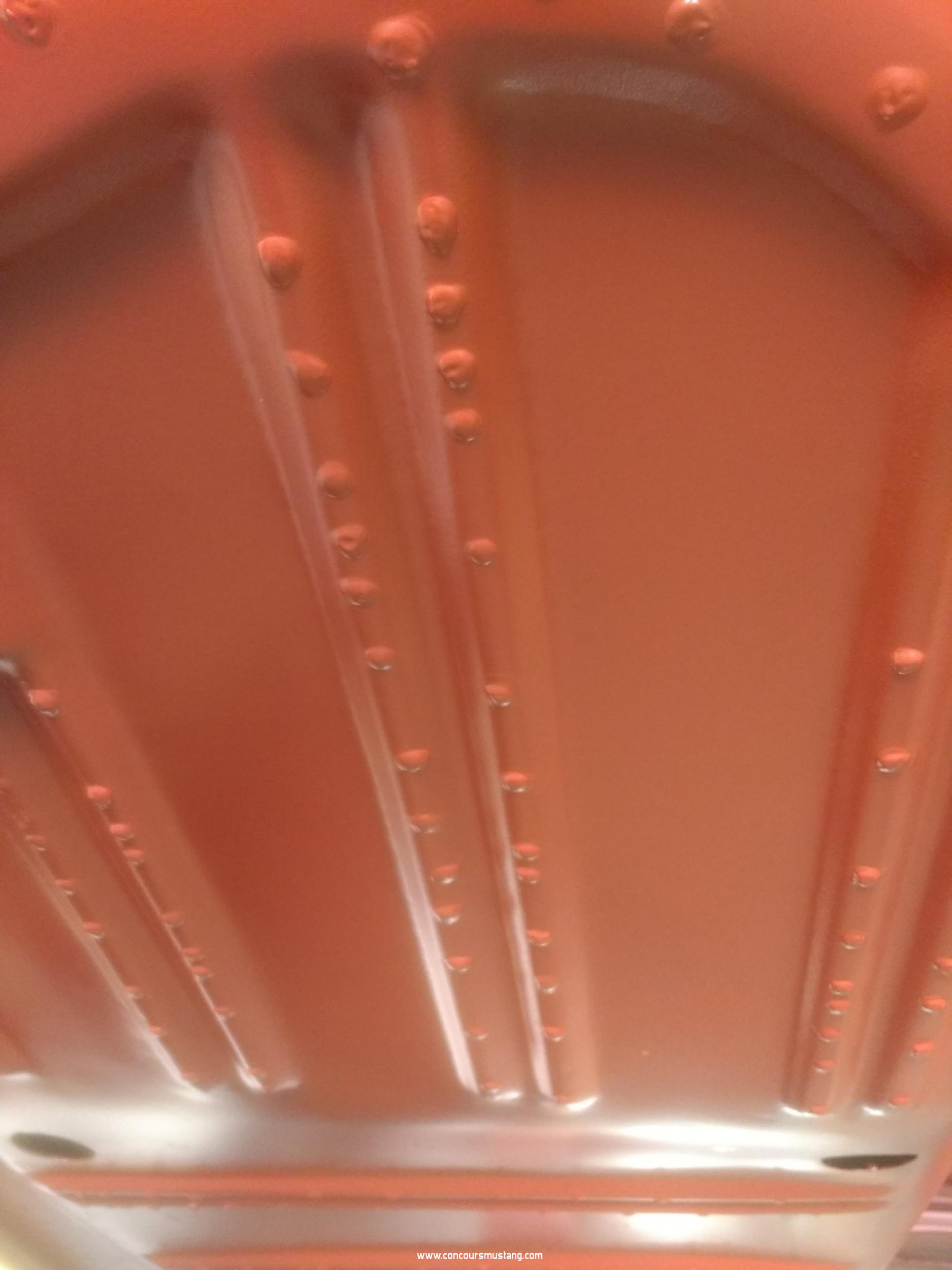

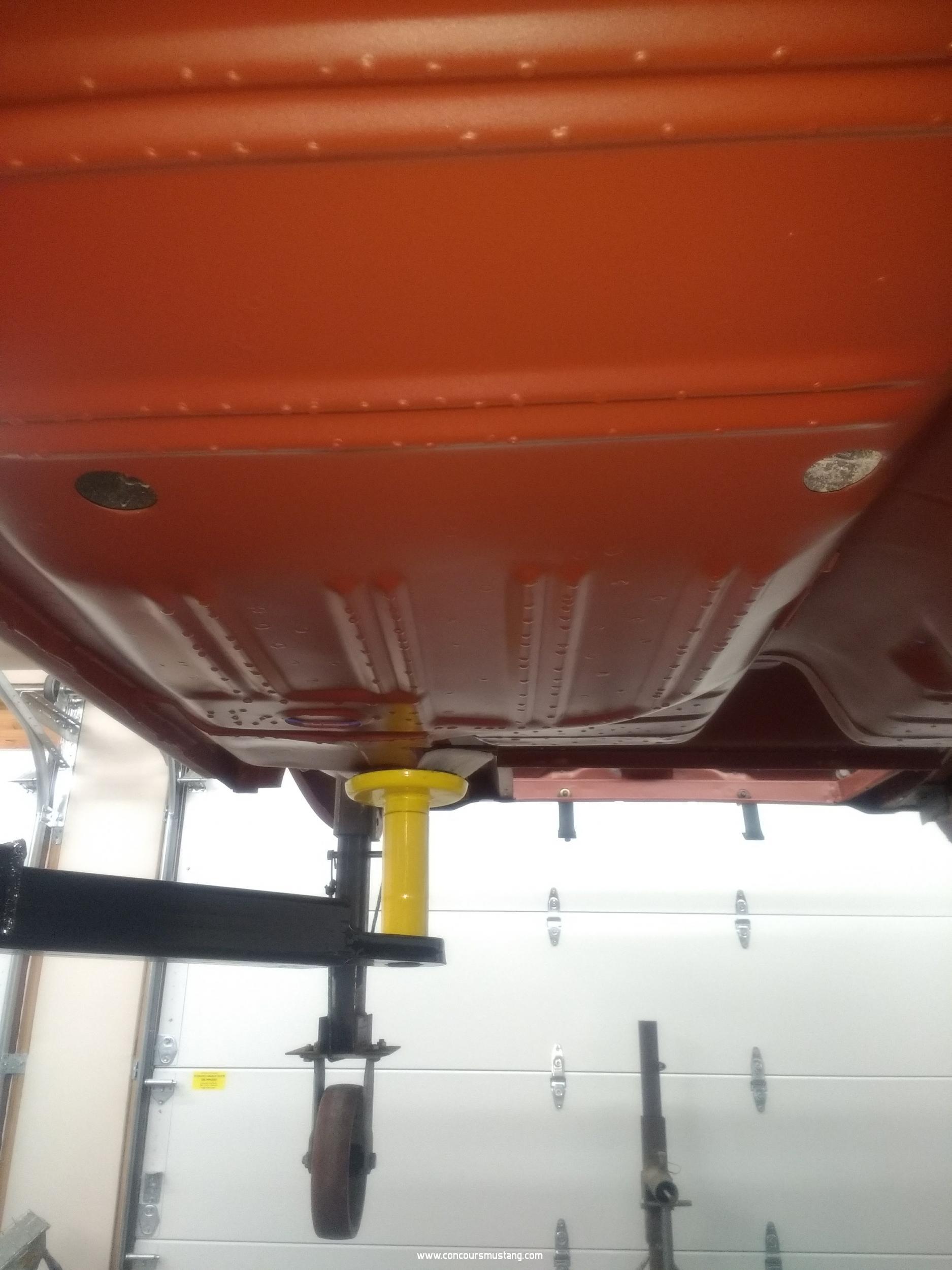

Finally had good enough weather to "do" my paint drips.
You be the judge ...
Great work Bill how did you emulate the paint drips

Thanks Bill all of then information you and others are providing is invaluable. Now I just need to try my best to see if I can do the instructions justice. I was going to leave the paint drips on my car as a lot of them remained after media blasting but decided to remove them before painting as the caps of the drips were removed and the remaining creaters would just not have looked right. Looking forward to experimenting with your procedures. I am going to start updating my build thread as I go and post the results if they turn out well.
Here is what my drips looked like after blasting and a photo of the drips before blasting and then a photo of the car painted with no drips. It is amazing how the some of the drips were really bonded to the metal and did not come off with the media blasting. Fortunately I have great photos of all of the drips on the bottom of my car. I have not seen may photos of other cars, but the drips do seem tone minimal on my car and will try to reproduces them as best I can. The down side is that I never put my car on a rotisserie and did all of the work so far on just a body cart. Do yo think that this process/procedure can work on the c art or just be harder as it will be done in a tight space under the car. I am not kicking myself for not putting the car on a rotisserie
